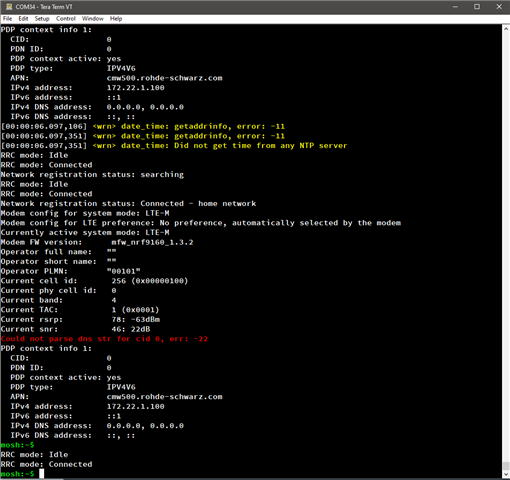

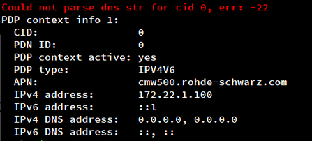

SDK1.9.1 with example of modem_shell.
modem fw is up to date, version 1.3.2
the fw crashes as soon as CMW500 trying to establish a connection.
"Stack overflow" is a keyword here. Try using addr2line using LR in order to find out what caused the crash. It looks to be related to something in the time_thread in date_time_core.c.
For 0x41000000/lr, type the following into the command line:
arm-none-eabi-addr2line -e <path to build\zephyr\zephyr.elf> 0x41000000
This will return a the line in the code related to the crash. Looking it up might give you some hints regarding the crash. This line would also be a good start for setting a break point.

When should I run those commands? Should I run the commands after the CMW500 triggered those error? Or I can ran it without CMW500 hooked up? It's a little bit confused to me what needs to be done at here. The screenshot I showed before is from the serial portal that connected to the DUT. but why the windows prompt is trying to prob the fw that built on my local PC? I don't understand that part.
It looks like you are almost there. You can run this command regardless of being connected to CMW500. However, you need to be running the command on a computer with access to the build folder for your application(it looks like you are doing so). The goal is to debug your application as arm-none-eabi-addr2line can be used to find out which part of your application's code was involved when Stack overflow occurred.

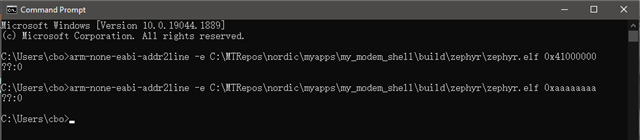

Thank you for posting the output from cmd. It is a good start that the computer is able to find arm-none-eabi-addr2line. Next thing, try removing '<' and '>' and insert the address in 'r14/lr' from the image in your initial post:
. It will also be interesting to see what is returned when inputting what is in r15/pc:
Please try these two commands and post what is returned:
arm-none-eabi-addr2line -e C:\MTRepos\nordic\myapps\my_modem_shell\build\zephyr\zephyr.elf 0x41000000
arm-none-eabi-addr2line -e C:\MTRepos\nordic\myapps\my_modem_shell\build\zephyr\zephyr.elf 0xaaaaaaaa
output result:
output result:
Hi Bo, sorry for the delay.
Thank you for sharing the output from addr2line. Unfortunately, the output does not help as much as I was hoping for.

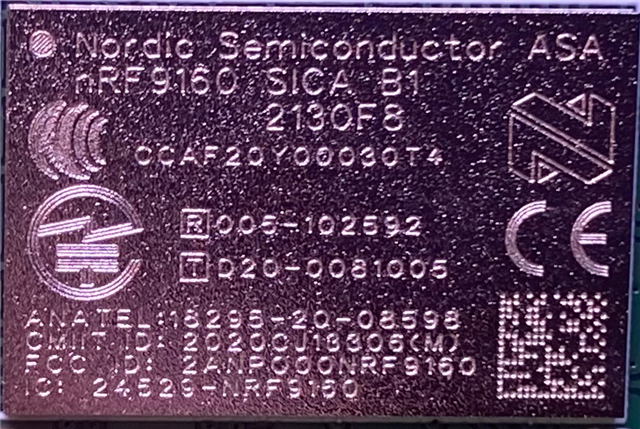

You could read out your revision by either AT command: AT%HWVERSION or look on the nRF9160 SIP for marking "B1".
"B1" -> Revision 2
"B0" -> Revision 1
Only revision 2 is supported by modem firmware v1.3.2.
Here is the SiP, HW version should be B1. I will upload CMW500 configuration file later.
Thank you for confirming the SIP version. It would be great if you could also comment on the DK HW version. This can be found on the back of the DK there should be a sticker, below 'PCA10090'. The version could be for example '1.0.0'.

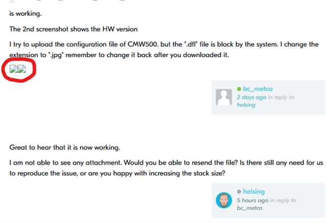

Please also let us know if you have tried increasing DATE_TIME_THREAD_STACK_SIZE.
It seems the solution is to increase
is working.
The 2nd screenshot shows the HW version

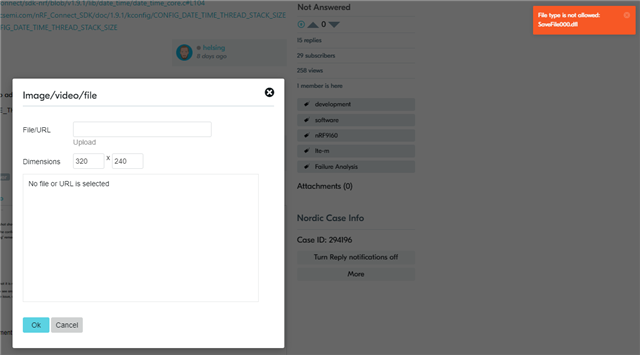

I try to upload the configuration file of CMW500. but the ".dfl" file is block by the system. I change the extension to ".jpg" remember to change it back after you downloaded it.
