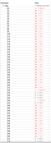

  • static nrf_esb_payload_t tx_payload = { .pipe = 0, .noack = false, };
    Then I am setting length and writing to data with memcpy manually before doing nrf_esb_write_payload() later on. I am writing my payloads in my ESB event handler. Note that I confirmed that this works perfectly as long as I use length and data of size 32. If I uses 252, I encounter weird behavior. Would you like me to provide an example say length 50 payload, what I'm sending and what I receive?
    Edit: I created an example for you.
    From this payload (off the static definition above, note that DATA is 0x01)
    tx_payload.data[0] = DATA;
    tx_payload.length = 51;
    uint8_t arr[50] = { '0', '0', '-', '0', '1', '-', '0', '2', '-', '0', '3', '-', '0', '4', '-', '0', '5', '-', '0', '6', '-', '0', '7', '-', '0', '8', '-', '0', '9', '-', '0', 'a', '-', '0', 'b', '-', '0', 'c', '-', '0', 'd', '-', '0', 'e', '-', '0', 'd', '-' };
    memcpy(&tx_payload.data[1], arr, 50);
    result_value = nrf_esb_write_payload(&tx_payload);
    I receive:
    Note that on the transmitter I have the latest NRF52 SDK and on the receiver I am using the Nordic Connect SDK. I checked their libraries, and they function equivalently, so it should not be a problem.
    It appears actually that data becomes erroneous and somewhat repeats with null bytes in-between exactly from byte 32. But I am using two NRF52 devices, so they definitely should support length 252 payloads.
