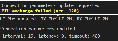

    I will first give a brief of what I am doing using  a part of code below to explain the code flow and how I am updating the configurations from peripheral side.

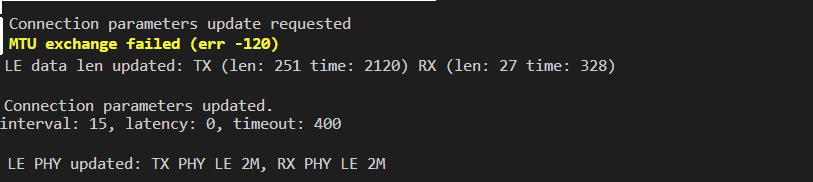

    In the above code, when nRF5340 receives '&' character from mobile app at  ble_rx_data[0] position, then it triggers below 4 configuration updates.
    update_connection_parameters();
    request_mtu_exchange();
    request_data_len_update();
    request_phy_update();
    The successful update of all these configurations needs some 2-3 seconds time (observed this in nRF connect mobile app). Once they are updated then data transmission starts from mobile app and nrf5340 starts writing into SD card using write_fs(). In this way my idea was to execute the required BLE configurations setup from nRF5340 side and app will only take care to enable these configurations and send data to store into SD card.
    Here, for DLE, from nRF5340 side, the function I was referring to is bt_conn_le_data_len_update() which is triggered inside request_data_len_update(). I hope this clears your query.
    as I know iOS only supports MTUs up to 184 bytes or so, and also indeed decides the MTU and won't pay much attention to what the peripheral is requesting.
    So overall transfer speed will be much lesser than what can be expected from Android?

    From what I can tell, data length extensions should be enabled here, yes. As long as the configs in your project also enable CONFIG_BT_DATA_LEN_UPDATE data length updates will be enabled. We also have the CONFIG_BT_AUTO_DATA_LEN_UPDATE to initiate a Data Length Update on connection establishments.
    The transfer speeds over iOS shouldn't be much lower, no. But a few bytes per second less must be expected.

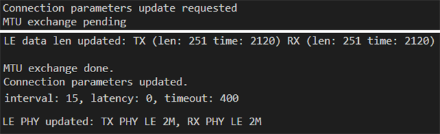

    I haven't added CONFIG_BT_DATA_LEN_UPDATE=y in nrf5340 project prj.conf but  when I checked the .config file at location, \build\hci_rpmsg\zephyr\.config file,  I can see CONFIG_BT_DATA_LEN_UPDATE=y and I think because of this I am able get below logs when I tested with our mobile app.
    Please correct me if I am misunderstanding anything.
    I just have one more query,
    as I can see while using our mobile app, LE PHY 2 Mbps mode, LE data len as per required length and Connection parameters are updating as per the requirement, then if I trigger MTU request of 498 from mobile app side then will that be a correct approach to be able to get the maximum data transmission throughput (around 1.3 Mbps which we have observed with DK to DK communication using throughput example)?
    We should observe atleast upto 1 Mbps with iOS then.
