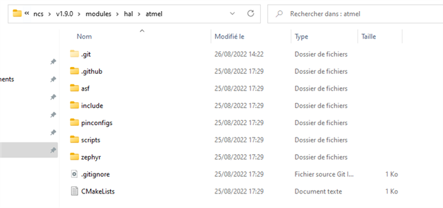

    I was able to add the hal_atmel module with west.
    This did not solve the problem. Now I get this.

  • Hi Hichem,
    When I try to add hal_atmel to nRF Connect SDK and run west update, the build is able to find these includes.
    It faces a new error, with the devicetree at that point.
    But you should be able to build your project now.
    Try to delete your build folder and rebuild the project.
    Try to update to nRF Connect SDK v2.0.2 and try the same in this version.
