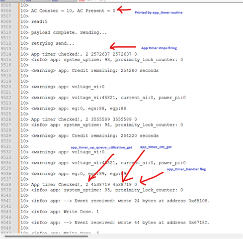

  • Hello Team,
    I am facing the same issue with app_timer2 and SDK17.
    My implementation is similar to John12's; I have app_timers running to control the modem state. In the timer handler, a flag is set, on which a function in main reads, executes the modem code, and then clears it.
    Sometimes I need the modem code to execute faster, so I periodically stop and start the timers.
    The code runs for some time; however, after hours, all app_timers stop firing without any error. I have APP_ERROR_CHECK() on both start and stop functions.
    app_timer_cnt_get()  still increments but however all app_timers stops firing.
    Any guide to resolve this is highly appreciated.
    Thanks.

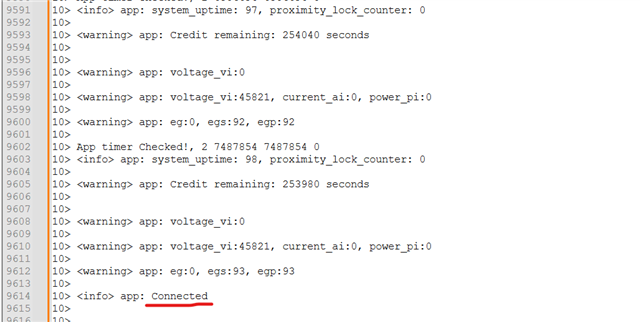

  • Adding more context
    1. Here is where app_timer stops firing
    2. Can still connect with BLE
    (There is a new app_timer created here for monitoring connection time)

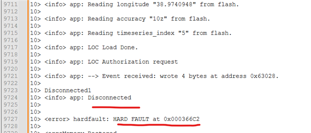

    3. Hardfault on ble disconnect
    (Disconnect stops the app_timer above)

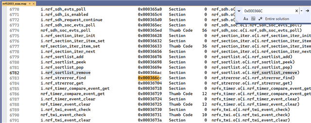

    4. map file
    Does the hard fault indicate a problem with the nrf_sortlist_remove function?
  • If you can still connect, but app_timer events are not handled, it sounds like your code might be stuck in a higher priority interrupt context. Have you debugged the application to see if it is stuck somewhere?
