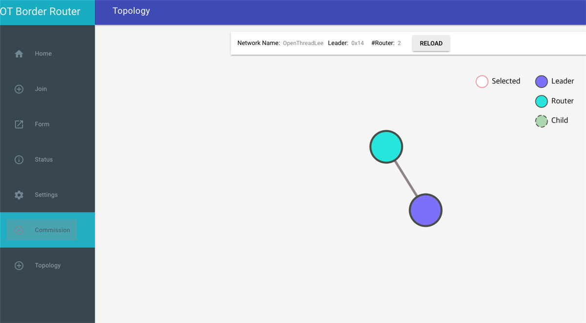

I am currently working on a Matter project.
I configured OTBR with Raspberry Pi, completed pairing with nRF52840 board (Light bulb), and confirmed that Light on/off works (use to chiptool command).
However, after rebooting the OTBR, the Chip tool light on/off command is not delivered to the Enddevice.
I checked the topology of Otbr web and found it was still connecting.
When Otbr is rebooted, the n52840 board log is also output as shown below.

After enddevice and Otbr are paired, if Otbr is rebooted, do I have to unconditionally pair again?
When tested using the Chip tool Android app, it was confirmed that the on/off command was delivered to the enddevice without re-pairing even if otbr was rebooted.
After pairing enddevcie and Otbr, even if Otbr reboots, please guide how to transfer to enddevice with chip tool command without re-pairing process.
Plesae guide
Thank you
Thank you
  • Hi
    After rebooting Otbr and restarting the otbr-agent
    After pairing with Enddevice for the first time, "chip-tool onoff on 321 1" command transmission success log

    After rebooting the Raspberry Pi, the otbr-agent service runs again, and if I check the enddevice side log, it is normally commissioned to Otbr again. However, the Fabric id has changed.
    I checked with out Matter developers. They responded that "If the OTBR reboot means some power cycling without changing datasets across reboots (so without starting new network) it should be working fine." You write "if I check the enddevice side log, it is normally commissioned to Otbr again.", does this mean you are performing a new commissioning operation after the reboot, or do you mean that the device is still commissioned in the network and joined successfully?
  • Hi Jørgen Holmefjord
    Looking at the Enddevcie log when the OTBR is rebooted, it doesn't seem to be newly commissioned.
    I think enddevice is still commissioned in the network and join successfully
