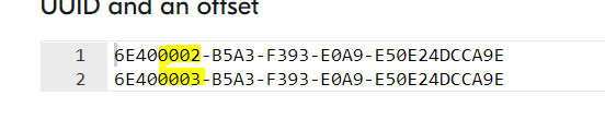

    The NUS example uses the following base UUID
    0x4C, 0x74, 0xA7, 0xB0, 0x00, 0x00, 0x00, 0x00, 0x00, 0x00, 0x00, 0x00, 0x00, 0x00, 0x05, 0x01
    And the BLEUUID class is generating the following UUIDs based on a base UUID and an offset
    6E400002-B5A3-F393-E0A9-E50E24DCCA9E
    6E400003-B5A3-F393-E0A9-E50E24DCCA9E
    But my UUID is entirely different. The UUID for the service is
    0x01, 0x05, 0x00, 0x00, 0x00, 0x00, 0x00, 0x00, 0x00, 0x00, 0x00, 0x00, 0xB0, 0xA7, 0x74, 0x4C
    and for each characteristic it is
    0x04, 0x06, 0x00, 0x00, 0x00, 0x00, 0x00, 0x00, 0x00, 0x00, 0x00, 0x00, 0xB0, 0xA7, 0x74, 0x4C
    0x05, 0x06, 0x00, 0x00, 0x00, 0x00, 0x00, 0x00, 0x00, 0x00, 0x00, 0x00, 0xB0, 0xA7, 0x74, 0x4C
    Can I handle this with an offset too? So I have to add
    0x03, 0x01, 0x00, 0x00, 0x00, 0x00, 0x00, 0x00, 0x00, 0x00, 0x00, 0x00, 0x00, 0x00, 0x00, 0x00
    as an offset?
    What is a good way to insert the correct UUIDs in this Python script?
  • Hi Daniel,
    Is it possible to change the UUID of the characteristic and service in your application ?
    If you are freely to change them I would suggest to follow what we did with the NUS example to have the same UUID base for the characteristic and the service, the only difference is the offset at byte 3rd and 4th.
    If it's not possible to change the UUIDs, then what you need to do is to define 3 different UUID base , and each of them would have byte 3rd and 4rd set to 0. In your case the 3rd and 4rd bytes are also 0 so you don't need to do anything.
    For example you can define this:
    self.your_base1 = BLEUUIDBase([
    self.your_base2 = BLEUUIDBase([
      self.adapter.driver.ble_vs_uuid_add(self.your_base1)
     self.adapter.driver.ble_vs_uuid_add(self.your_base2)
    Then you can call:
    self.your_first_char = BLEUUID(0x0000, self.your_base1)
    self.your_second_char = BLEUUID(0x0000, self.your_base2)
    After that you can use your_first_char  and your_second_char  the same as what we did with the nus_rx and nus_tx.
    In short the BLEUUID() is the combination of the 3rd and 4th bytes and the base_uuid.
    Then you can call:
