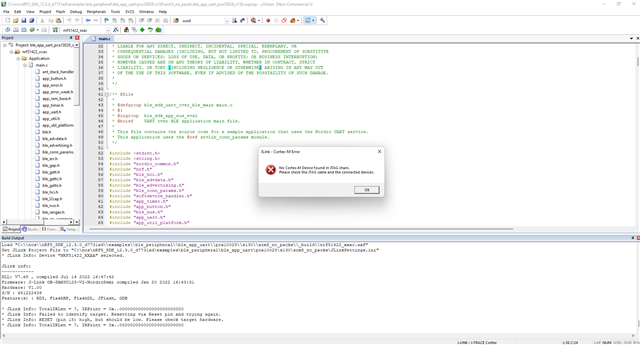

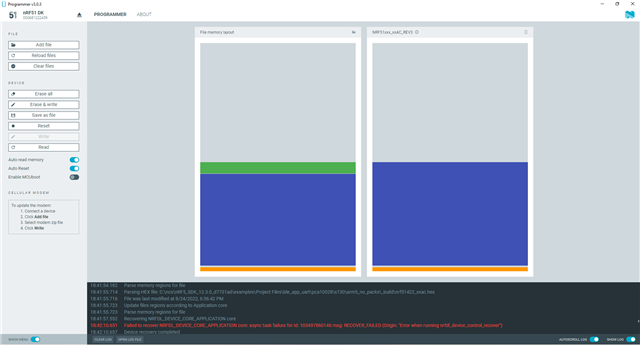

Hello, I am currently trying to program the uart example code from the nRF5_SDK_12.3.0_d7731ad zip file. After dealing with various reference address and device package issues, I am now able to flash the softdevice and progam sets to the chip. However, the chip is not advertising and it does work with the premade hex file. At this point I have no idea what could be wrong, the only noticible difference between the hex file layout in nRF Connect and the flashed softdevice and code from Kiel 5 is shown in the attached image, with hex file on the left covers the register address from 0 to 0x0001E3F7 while the flashed program from Keil goes from 0 to 0x0001E3FF. Other than that the recovery error is shown in the command window, but this occured even for the hex file which would advertise so I am unsure how to proceed.

  • I went to verify something and now the Jlink-Cortex M error has returned. I thought this was finally resovled but it would appear not to be the case. I was able to flash the softdevice, so it seems to only be related the actual code itself. Was able to flash the blinky program onto the board.

  • I was able to fix the Cortex M error by changing the Port from JLink to SW.
