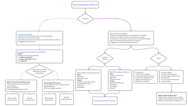

Firmware CI runner device helpers / signing device certificate in nRF9160
I've used the module https://github.com/NordicSemiconductor/cloud-firmware-ci-device-helpers-js to create device certificates for a nRF9160 device and then AWS JITP when the device connects. The module uses PC to sign the modem generated key and the PC connection requires UART.
I'm facing a problem that I have a product that doesn't have UART available. Is it possible to do the signing process inside the device? Or is a bootstrapping certificate better way to go?
