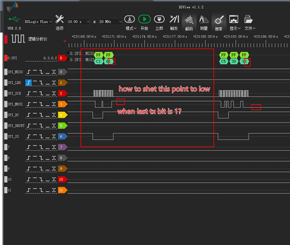

How do I set the SPIM3 parameter so that MOSI is low after SPIM3 has sent a byte 0x01?
The test environment
DK PCA10056
SDK :sdk17.1
example :spim3
Thank you for all your assistance.
Peter.Min

Although not specified, the state of the MOSI after the transaction is the same as the MSB of the last byte from the TX buffer. This can't be changed as it's part of the HW implementation. You can disable the SPI after the transaction, in that case the pin will revert to whatever the GPIO was configured to before the SPI.
regards
Jared
Hi Jared,
Final solution
Customers can solve this problem by adding one more 0 or 1 byte
Peter.Min
