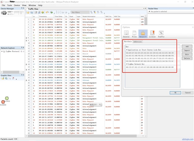

    Can you please provide a sniffer trace from the network when this error occurs?
    Jørgen
  • I'm not able to read the sniffer trace due to "Bad FCS". Can you provide the network key used? I tried the ones from your attached logs, but these does not seem to work.
  • Please check these 2 key files.
    5A:69:67:42:65:65:41:6C:6C:69:61:6E:63:65:30:39
    62:A5:5C:9B:F0:5E:37:99:70:26:67:66:8D:4D:8B:F8
    C5:28:1E:F6:8E:61:91:1C:97:2A:77:D1:EF:FE:6D:C1
    CD:50:FD:CB:B7:B7:82:C0:E7:00:9D:23:14:56:72:1C
    AB:CD:EF:01:23:45:67:89:00:00:00:00:00:00:00:00
  • Unfortunately, I'm not able to read it correctly using those keys. Did you capture the sniffer trace using the Nordic 802.15.4 sniffer, or did you use the sniffer tool from your screenshot? I may be missing some component in Wireshark if it is captured using another tool than the one I have installed.
