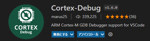

I tried building and debugging the sample "https_client" using the method described here.
But debugging fails. Debugging stops prematurely because the source file cannot be found.
Module: nRF9160-DK
SDK: Connect SDK v2.0.0
firmware: mfw_nrf9160_1.3.2.zip
The settings and extended functions when creating the application, and the contents of the output are as follows.
Settings
extension
output
We will also send you the logs output during build, flash, and debug, so please check them.

Cortex-Debug: VSCode debugger extension version 1.6.0 git(3026299). Usaage info: https://github.com/Marus/cortex-debug#usage
Warn: c:/Users/protec/Desktop/https_client/build/zephyr/merged.hex is not an ELF file format. Some features won't work -- Globals, Locals, disassembly, etc.Launching GDB: "c:\\ncs\\toolchains\\v2.0.0\\opt\\zephyr-sdk\\arm-zephyr-eabi\\bin\\arm-zephyr-eabi-gdb-no-py.exe" -q --interpreter=mi2
    IMPORTANT: Set "showDevDebugOutput": "raw" in "launch.json" to see verbose GDB transactions here. Very helpful to debug issues or report problems
Launching gdb-server: "C:\\Program Files (x86)\\SEGGER\\JLink\\JLinkGDBServerCL.exe" -singlerun -nogui -if swd -port 50000 -swoport 50001 -telnetport 50002 -device nRF9160_xxAA -select usb=960007184 -rtos "C:\\Program Files (x86)\\SEGGER\\JLink\\GDBServer\\RTOSPlugin_Zephyr.dll"
    Please check TERMINAL tab (gdb-server) for output from C:\Program Files (x86)\SEGGER\JLink\JLinkGDBServerCL.exe

Thread 2 hit Temporary breakpoint 1, main () at C:/ncs/v2.0.0/modules/tee/tf-m/trusted-firmware-m/secure_fw/spm/cmsis_psa/main.c:130
130	    __ASM volatile(
[New Remote target]
build settings
I would be very happy if you could tell me how to solve it.
(In this state, nothing was displayed even when connected to LTE Link Monitor.)
