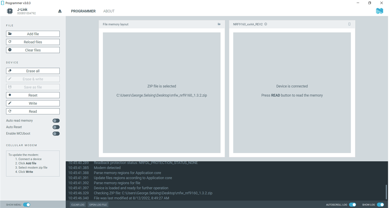

Step 1. Power up the board and flash the latest modem onto the NRF9160.
(Fig. 1 We can see that the chip is recognized through the Jlink and I am able to program it here)
(Fig. 2 Latest firmware file added and we can see further that we are talking to the correct chip)

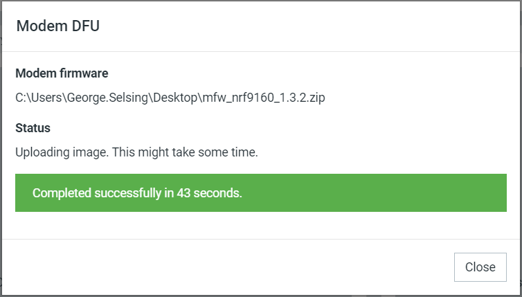

(Fig. 3 Modem is programmed onto NRF9160)

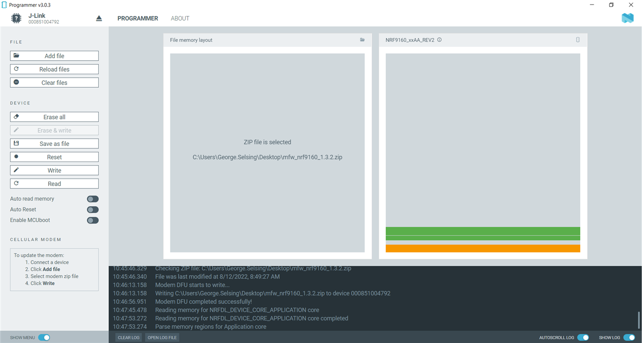

(Fig. 4 Modem is programmed onto the NRF9160 part 2, we can see that the chip has something or other on it now)

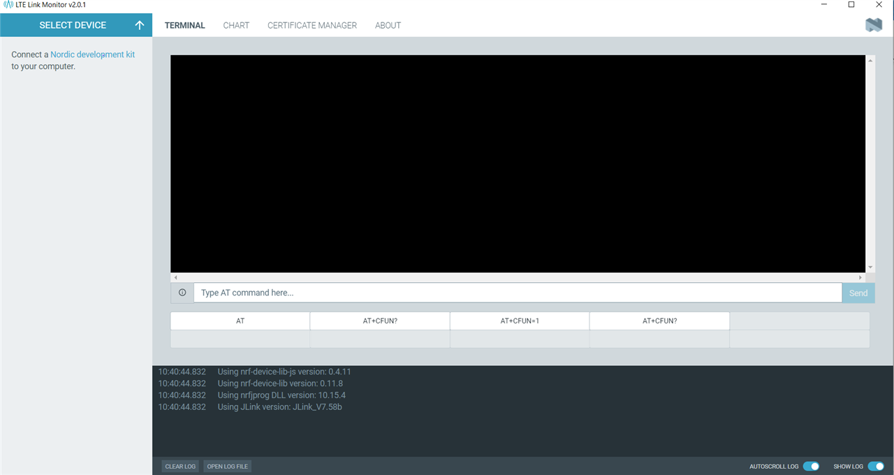

Step 3. Open up the LTE Link Monitor App on the NRFConnect and try sending some AT commands to check out some of the cellular functionality
(Fig. 7 NRF9160 does not show up as a connected device)
This is where it all goes wrong and my dreams are shattered. For the life of me, I cannot get the NRF9160 to show up in the LTE Link Monitor to connect to it and try sending AT commands. The real kicker? Some of my peers were testing this board out about 2 months ago and got the device to connect in the LTE Link Monitor, sent AT commands, saw it working properly, called it good and shelved the board until we needed it later. Well now it's later and I'm re-figuring it out because they did not document any of it. Now, this isn't me trying to bash my peers, more just providing context on the fact that the board should be working on a hardware level as it has worked fine before, but is not now.

  • Hello!
    I believe the LTE Link Monitor uses a virtual COM port to communicate with the nRF9160, and I notice that only RTT is detected in your VSCode screenshot.
    So I suspect your issue might be caused by talking to the nRF9160 through a Jlink debugger.
    Did your peers two months ago use exactly the same setup?
    Einar
  • That led me in the right direction! The Jlink only had the SWO/SWDIO/SWCLK pins connected to the NRF9160. Turns out the LTE Link Monitor wants to talk through the Rx Tx UART line, which I soldered some wires to on the board and ran through serial->UART cable. After that I was able to see the device in the LTE Link Monitor and send AT Commands. Thanks for the push in the right direction, I guess my peers forgot about having to break out the Rx and Tx but when I showed them they remembered that that is what they also did.
