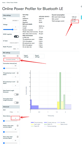

The Online Power Profiler ( Online Power Profiler for Bluetooth LE ) shows a reduction in power usage for the central with non-zero Slave Latency figures. Why is this? I thought Slave latency only reduced power for the peripheral.
Thanks for notifying us on the matter, this is indeed a bug. Slave Latency slider should not be usable when selectin central. as this is a peripheral function. So just set Slave Latency = 0 for now as a work around until we fix the bug in the Online Power profiler.
That is correct.
