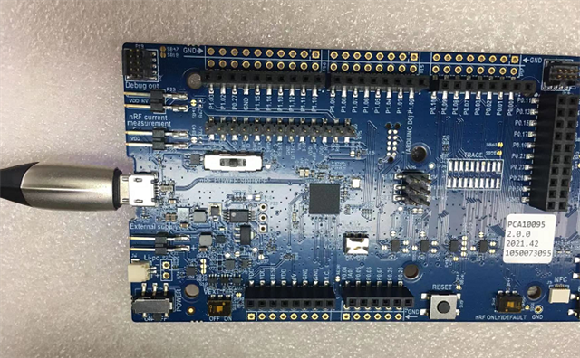

nRF5340, NCS2.0.2, vscode.

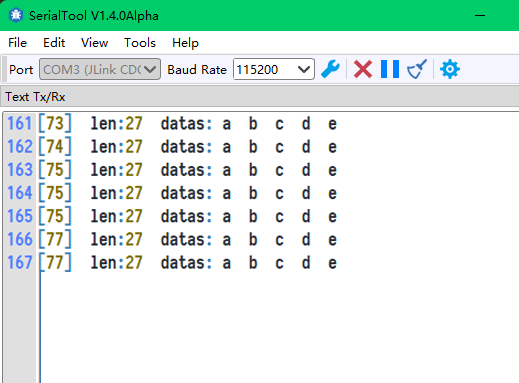

when TX and RX work on PHY_1M,  two side work well.

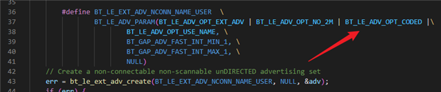

but when TX side set  BT_LE_ADV_OPT_CODED and RX side set BT_LE_SCAN_OPT_CODED,  RX side frequent data loss.
the frist data byte for Serial number (like 0 1 2 3 4....),
interval 100ms  bt_le_per_adv_set_data(), RX side will loss some Serial number data.
how config it?

		#define BT_LE_EXT_ADV_NCONN_NAME_USER  \
	   			BT_LE_ADV_PARAM(BT_LE_ADV_OPT_EXT_ADV | BT_LE_ADV_OPT_CODED | \
						BT_LE_ADV_OPT_USE_NAME, \
						BT_GAP_ADV_FAST_INT_MIN_1, \
						BT_GAP_ADV_FAST_INT_MAX_1, \
						NULL)
	// Create a non-connectable non-scannable unDIRECTED advertising set
	int err = bt_le_ext_adv_create(BT_LE_EXT_ADV_NCONN_NAME_USER, NULL, &adv);

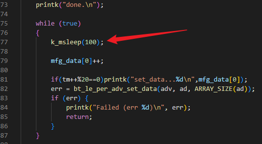

	while (true)
		k_msleep(100);
		mfg_data[0]++;// The first byte acts as a sequence number, increment it for every data update
		err = bt_le_per_adv_set_data(adv, ad, ARRAY_SIZE(ad));
		if (err) {
			printk("Failed (err %d)\n", err);
