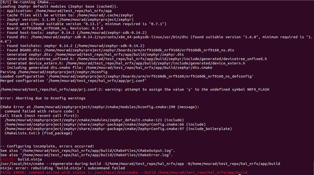

I'm trying to create a HAL library to use it with zephyr application
From what I have read I need to create another module .
I can't figure out how to set up the module and how to compile it.
for the moment I have only 1 module to add with the following files hal_flash.c and hal_flash.h
How can I add cmake files kconfig files to make it work with zephyr application
note: app on nRF9160
  • I used this project as reference https://github.com/zephyrproject-rtos/hal_nrfx
    I made those changes:
    and added flash.h file to "nrfx/drivers/include" and flash.c to "nrfx/drivers/src/"
    and changed the CMakeLists and added this line
    zephyr_sources_ifdef(CONFIG_NRFX_FLASH   nrfx/drivers/src/hal_flash.c)

    In the prj.conf I added
    CONFIG_NRFX_FLASH=y
    but I keep getting this error when I try to build with "west build -p auto -b nrf9160dk_nrf9160_ns ."
  • Hello
    Any reason you're trying to put your driver into the nrfx tree?
    If I wanted to include my own driver in a project I would just put the files under src/ in the application folder.
    Then you'll just need to add your drivers as sources in CMakeLists, see for example the Asset Tracker v2 sample in NCS as an example of how this is done.
    The error you're getting means that your CONFIG_NRFX_FLASH symbol isn't defined properly.
    I'm not entirely sure what you'll have to do to make Kconfig recognize your config symbol, but I can look into it.
