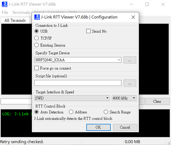

I have to use the USB interface to send and receive data between the host PC and the nRF52840 chip.
In the example, I can only send the data from the chip to the computer through EPIN2, but can not send the data from the computer to the chip through EPOUT2.
 • send the data from the chip to the computer
   Press Button 2 → send the data through EPIN2 → SUCCESS (the array that the chip sent shows on the Python terminal, and "transfer complete" shows on PUTTY)
 • send the data from the computer to the chip
   Input the data (I use RTT Viewer to send the data. But when I input the string, it shows the warning messages.) → FAIL
What should I do to let the data transfer successfully?
What function should I add to call the NRF_DRV_USBD_EVT_EPTRANSFER event to let the receive_custom_data() function work?

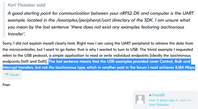

    So I searched online to confirm if I could use this example to get a higher data rate than HID full speed.
    Then I found this page. The questioner mentioned that he read in another post in the forum said the USB examples could achieve 8,184 Mbps. (I think he means 8.184Mbps.)
    Could the program that I used achieve such a high data rate? Or it can be higher than HID full speed is fine. (More than 2 Mbps is better.)
    What method should I use to achieve it?
    Ning
  • Hi Ning
    You should be able to get a higher speed if you use a different USB class, such as CDC or MSC.
    We have done some testing internally to evaluate the transfer speed using these classes, and got the following results:
    MSC write zeros to an empty drive (Linux): 513 kB/s (4104 kbit/s)
    CDC ACM binary file transfer (Linux): 323 kB/s (2584 kbit/s)
    CDC ACM binary file transfer (Windows): 215 kB/s (1720 kbit/s)
    I don't know where the 8Mbps number comes from, but keep in mind that if you use an isochronous endpoint you are not guaranteed to have all the data come through, and you would have to accept a certain amount of packet loss.
