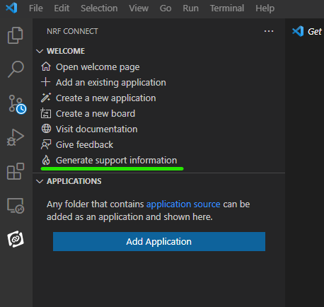

  • Hi  Melt,
    Sorry for the delayed response. Could you attach the Support Information?
    -Priyanka

    Thanks for the information. This could be because of the default configurations. Could you try to make the changes mentioned in this ticket? The number of connections is limited to 20 for our softdevice controller.
    -Priyanka
