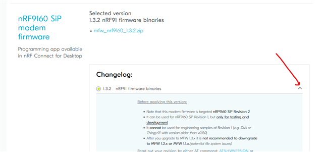

  • Hi Ludwig,
    Sorry I did not see this right away: It looks like you are using a combination of modem firmware and nRF Connect SDK versions that are not supported:
    Please see this matrix showing compatibility: https://infocenter.nordicsemi.com/topic/comp_matrix_nrf9160/COMP/nrf9160/nrf9160_modem_fw.html?cp=2_0_3_5
    In general, it is also recommended that you upgrade to revision 2(B1).
  • The nrf9160dk I have has a B1 nrf9160.
    Using mfw1.3.2 on it I instead get the following error during same circumstances:
    [00:03:11.744,506] <err> modem_module: Modem error: 0x4, PC: 0xe4648
