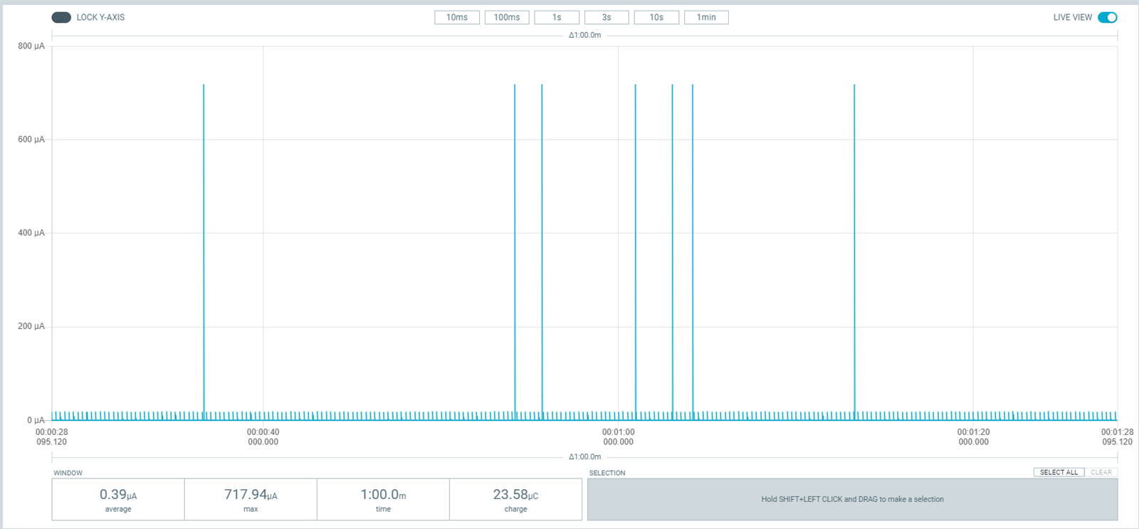

abnormal current peak when system off (0.6mA)
Hello everybody.
I am developing a BLE application in which I am using WDT every 12 seconds and a RTC interrupt every 10 seconds to send some information.
When you press a button for a short period of time the device goes into SYSTEM OFF MODE and it only wakes up when you press the button again.
The problem is that besides I am having the average current of 0.4uA for SYSTEM OFF MODE, using the PPK2 I can see some stranges peaks of current from time to time (it seems they are not periodic).
Can anyone explain me, please, if this is a normal peak or I am missing some configuration?
