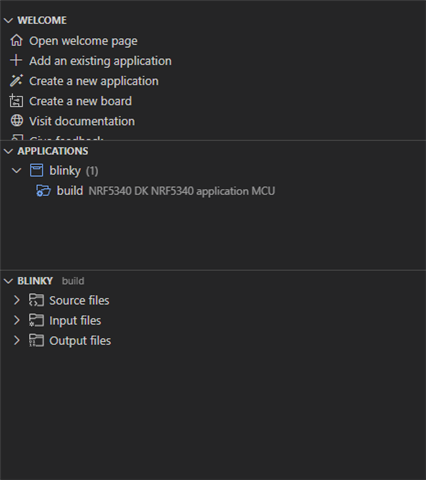

I have a thingy 53 that I got from the HacksterIO competition, I'm trying to program it using the Programmer application from the NRF Connect Desktop application.

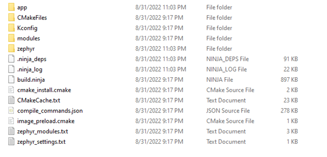

I open Toolchain Manager, boot VS code and build one of the examples (blinky) applications (I don't want to use prebuild). The build that VS code produces is not flash-able from the Programmer application. What can I do so I can write my own code and flash it using the Programmer application?

    The Thingy:53 does not have an on-board debugger, which is why it is not showing up in the 'connected devices' in the VSC.
    This also means that you are not able to flash the Thingy:53 through the VSC 'flash' action, as you would a regular nRF5340 DK.
    Instead, you will have to perform a DFU in order to flash your Thingy:53 - you could do so using any of these methods.

    The DFU ready application can be found in the _YOUR/PATH/build/zephyr/dfu\_application.zip_ location.

    But after I build this code you posted, how can I flash it on my device using the NRF Programmer application from the NRF connect application?
  • Yes, after building the project based on the minimal project described in my previous comments you will find the DFU image at YOUR/PATH/build/zephyr/dfu_application.zip. You can update your Thingy:53 as described in the Updating over USB section of the documentation - inputting the dfu_application.zip in the nRF Connect for Desktop Programmer application.
