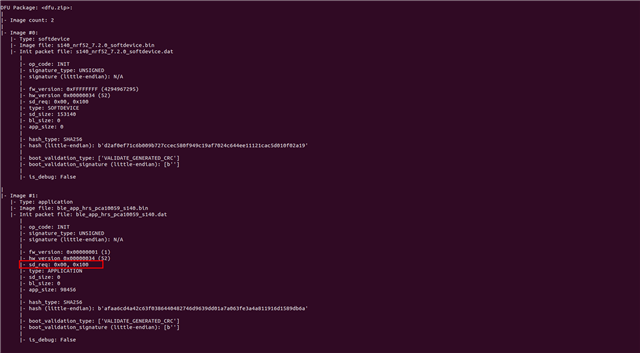

  • Hi Louis,
    The init command for the application update must include the FWID of the Softdevice the app was built for (i.e. 0x0100 if you still use s140 v7.2.0), and not 0x00. When the FWID is 0x00, it tells the bootloader that the application is meant to run without the Softdevice, so it will overwrite it.
    Can you post the command you used to make the combined Softdevice+application update package?
  • Hi Vidar,
    this is the command I used:
    nrfutil pkg generate --hw-version 52 --application app.hex --application-version 1 --sd-req 0x00,0x100 --sd-id 0x100 --softdevice s140_nrf52_7.2.0_softdevice.hex --key-file private_key.pem app_sd_dfu_package.zip
    BR
    Louis
  • Hi Louis,
    Thanks. I see from your command that you are correctly setting the FWID requirements so you are likely experiencing this bug that was addressed in nrfutil v6.1.7:  https://github.com/NordicSemiconductor/pc-nrfutil/releases
    Please upgrade nrfutil and try again.

  • I don't see any problems with what you have done so far.
    The only way the application update will be allowed to overwrite the Softdevice is if the signed init command for the app contains 0x00 in its  SD FWID list as shown below.
    Output from 'nrfutil pkg display 'ZIP_FILE' command:
