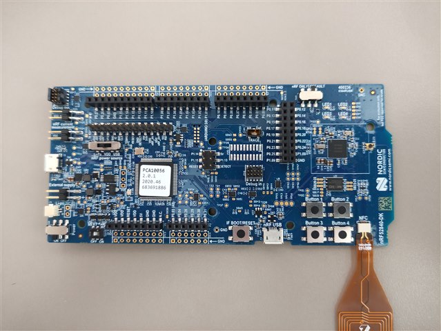

Greetings,
during test of a device, we have tried uploading a shell sample in a nrf52840dk board. However for some reason this caused the board, or at least the installed JLINK, to stop working.
Trying to connect via SES gives us a Error Reported popup saying "Failed to connect to target. No idcode detected. Please check connection and Target Interface Type"
The target output gives us the following:

Trying with nrfjprog --recover -f NRF52 the output is
ERROR: Unable to connect to a debugger.

JLink proved similarly unsuccessful
SEGGER J-Link Commander V7.58b (Compiled Nov 16 2021 15:04:43)
DLL version V7.58b, compiled Nov 16 2021 15:04:27
Connecting to J-Link via USB...O.K.
Firmware: J-Link OB-SAM3U128-V2-NordicSemi compiled Feb  2 2021 16:47:20
Hardware version: V1.00
S/N: 683691886
License(s): RDI, FlashBP, FlashDL, JFlash, GDB
VTref=3.300V
Type "connect" to establish a target connection, '?' for help
J-Link>connect
Please specify device / core. <Default>: NRF52

Cannot connect to target.
J-Link>q
Starting the DK in bootloader mode shows us only the following:
.fseventsd/no_log
System Volume Information/IndexerVolumeGuid
.metadata_never_index
.Thrashes
bootload.htm
Apparently no DLL to be found, though downloading and copying the j-link-ob-sam3u128-v2-nordicsemi-170724.bin file in the BOOTLOADER folder hasn't helped
Is it even possible to restore the board to a working state at this point? And what can we do to avoid SES killing further boards in the future?
