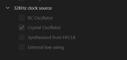

 I am using nRF connect SDK  V2.0.2 chipset 52832 built using VS code.
 Need to move the setup from an external clock to an internal RC oscillator.
 When I disable "Hardware Clock Controller Support" in KConfig I get errors. Not able to select any option in the "32Khz" clock source. Image attached. Please suggest how to enable the internal oscillator
  • 32KHz clock source have direct dependency on CLOCK_CONTROL that you are trying to disable.
    32KHz clock source
    No description available.
    Direct Dependencies: (=y)
    CLOCK_CONTROL_NRF (=y)
    && CLOCK_CONTROL (=y)
    You need to enable CLOCK_CONTROL and CLOCK_CONTROL_NRF  to have this option available, else they are greyed out.

  • This is defined in zephyr\drivers\clock_control\Kconfig.nrf but you might not see this if you have disabled the clock control (CLOCK_CONTROL ) in your proj.conf

  • I am sorry, I read this wrong. We need to have CONFIG_CLOCK_CONTROL enabled (and by default it is enabled).
    You just need to add this line to your proj.conf
    and I get this in the final .conf file
