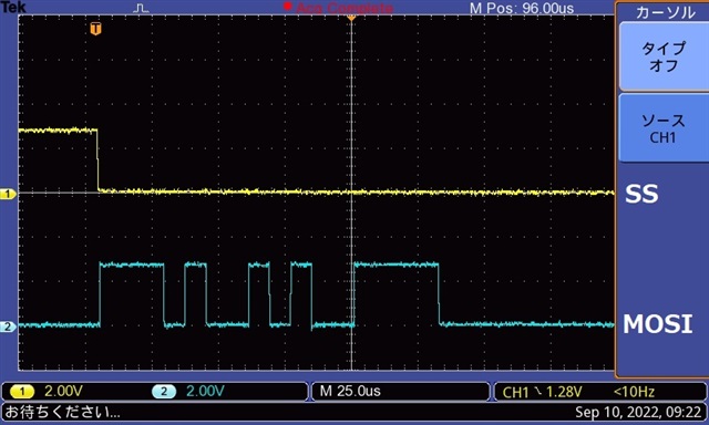

    When SCLK is open.
    SS and MOSI wave form

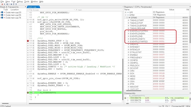

    EVENTS
    When write to TASKS_START=1, as soon as, EVENTS_ENDRX/EVENTS_END/EVENTS_ENDTX is '1'.

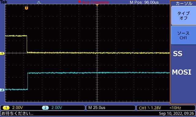

    When SCLK is connect to GND.
    SS and MOSI wave form(MOSI is not change.)

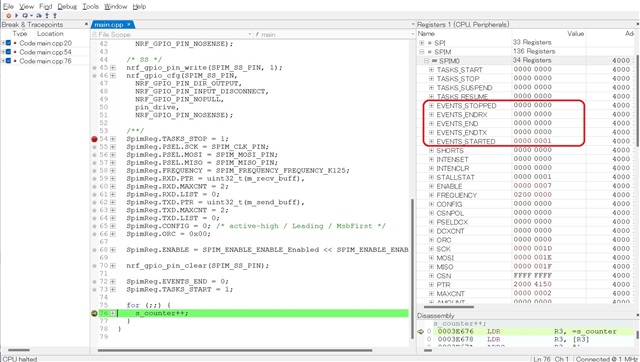

    EVENTS
    EVENTS_ENDRX/EVENTS_END/EVENTS_ENDTX is never '1'.
