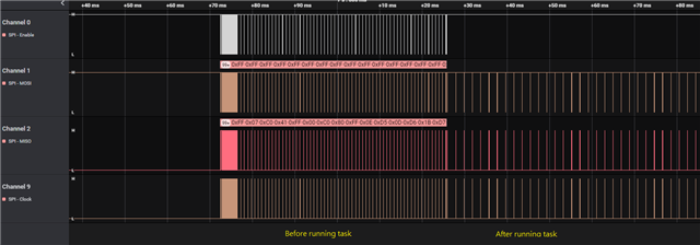

We have a freeRTOS project using nRF52840, I found that if I put SPI transfer API before running task is OK, but it has a problem if I put in the task,
Does anyone know how to use SPI(easyDMA) in freeRTOS?

thank you, I think is our PCBA problem, it is workable on DK.
