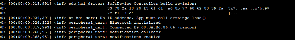

  • Hi Jh,
    How did you tested ?
    I did a quick test here with the peripheral_uart (added send_enabled() callback)  and the central_uart and here is what I saw in the log:
    Or this after security is removed:

    The log is from the Peripheral unit:
    Could you reproduce with the peripheral_uart  example ?
    I attached the example that I used to test here.
    8168.peripheral_uart.zip
    Or if you can send us the code for the central and peripheral that can reproduce the issue. It would be nice.
