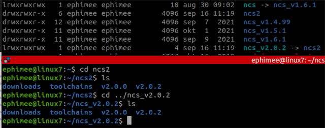

Zephyr was unable to find the toolchain
My system details:
  • Ubuntu 20.04.04 LTS
  • Visual Studio Code 1.70.2
  • NCS 2.0.2
  • nrfutil version 5.2.0
  • Toolchain Manager v1.1.3
I'm trying to build my project, but it cannot find the toolchain:
Executing task: nRF Connect: Build: myproject/build_nordicDK (active)
Building myproject
west build --build-dir /home/ephimee/myproject/build_nordicDK /home/ephimee/myproject
ZEPHYR_BASE:= /home/ephimee/ncs2/v2.0.2/zephyr
Loading Zephyr default modules (Zephyr base (cached)).
-- Application: /home/ephimee/myproject
-- Cache files will be written to: /home/ephimee/.cache/zephyr
-- Zephyr version: 3.0.99 (/home/ephimee/ncs2/v2.0.2/zephyr)
-- Found west (found suitable version "0.13.1", minimum required is "0.7.1")
-- Board: nrf52840dk_nrf52840
-- Found host-tools: zephyr 0.14.1 (/home/ephimee/ncs_v2.0.2/toolchains/v2.0.2/opt/zephyr-sdk)
-- Found dtc: /usr/bin/dtc (found suitable version "1.5.0", minimum required is "1.4.6")
-- Found toolchain: gnuarmemb (/home/ephimee/ncs2/v2.0.2/zephyr/cmake/toolchain/gnuarmemb)
CMake Error at /home/ephimee/ncs2/v2.0.2/zephyr/cmake/compiler/gcc/generic.cmake:9 (message):
  Zephyr was unable to find the toolchain.  Is the environment misconfigured?
  User-configuration:
  ZEPHYR_TOOLCHAIN_VARIANT: gnuarmemb
  Internal variables:
  CROSS_COMPILE:
  /home/ephimee/ncs2/v2.0.2/zephyr/cmake/toolchain/gnuarmemb/bin/arm-none-eabi-
  TOOLCHAIN_HOME: /home/ephimee/ncs2/v2.0.2/zephyr/cmake/toolchain/gnuarmemb
  /home/ephimee/ncs2/v2.0.2/zephyr/cmake/modules/generic_toolchain.cmake:51 (include)
  /home/ephimee/ncs2/v2.0.2/zephyr/cmake/modules/zephyr_default.cmake:121 (include)
  /home/ephimee/ncs2/v2.0.2/zephyr/share/zephyr-package/cmake/ZephyrConfig.cmake:51 (include)
  /home/ephimee/ncs2/v2.0.2/zephyr/share/zephyr-package/cmake/ZephyrConfig.cmake:81 (include_boilerplate)
  /home/ephimee/myproject/build_nordicDK/CMakeLists.txt:15 (find_package)
FATAL ERROR: command exited with status 1: /usr/bin/cmake -DWEST_PYTHON=/usr/bin/python3 -B/home/ephimee/myproject/build_nordicDK -S/home/ephimee/myproject -GNinja
How can I make west build more verbose?
Why does the log say it found the toolchain and then it didn't find the toolchain?
Contents of /home/ephimee/.config/Code/User/settings.json:
    "nrf-connect.welcome.showOnStartup": true,
    "nrf-connect.topdir": "/home/ephimee/ncs2/v2.0.2",
    "nrf-connect.toolchain.path": "/home/ephimee/ncs2/toolchains/v2.0.2",
    "nrf-connect.enableTelemetry": true,
    "extensions.ignoreRecommendations": true,
    "cortex-debug.JLinkGDBServerPath": "/opt/SEGGER/JLink/JLinkGDBServerCLExe",
    "nrf-connect.applications": [
        "/home/ephimee/myproject"
    "cortex-debug.armToolchainPath.linux": ""
Parents Reply
  • Hi Philip,
    It looks like you have now two different installations. As I had mentioned before, before re-installing, you need to uninstall and remove all previous folders. Could you try uninstalling the nRF Command line tols, nRF Connect SDK and also delete all previous folders relating to Nordic? For eg, the ncs2, ncs_v2.0.2 etc. Please delecte all the folders, uninstall everything and then please download everything once again (this time everything to same path).
    -Priyanka
