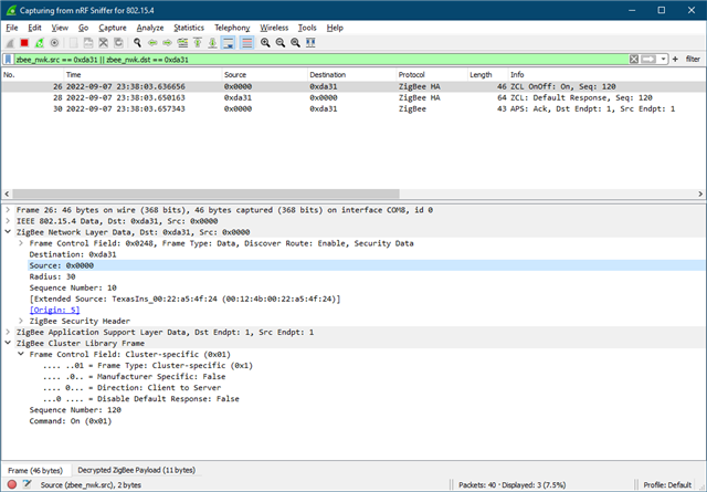

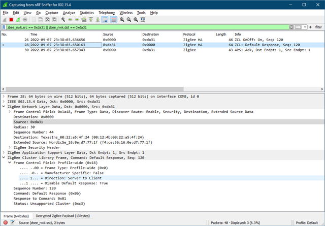

Problem 1:
Z2M allows the DK device to join.  During Z2M initialisation, Z2M attempts to read data from the DK, but results in an error. I think this is what the EP callback should be handling, but I cannot find any information of how to implement the EP handler.
Problem 2:
When a button is pressed on the DK, the ON OFF state is sent to Z2M, Z2M logs show this:
Debug 2022-09-06 13:44:42
Received Zigbee message from '0xf4ce367b62161a91', type 'commandOff', cluster 'genOnOff', data '{}' from endpoint 1 with groupID 0
No converter available for 'test_manuf' with cluster 'genOnOff' and type 'commandOff' and data '{}'
