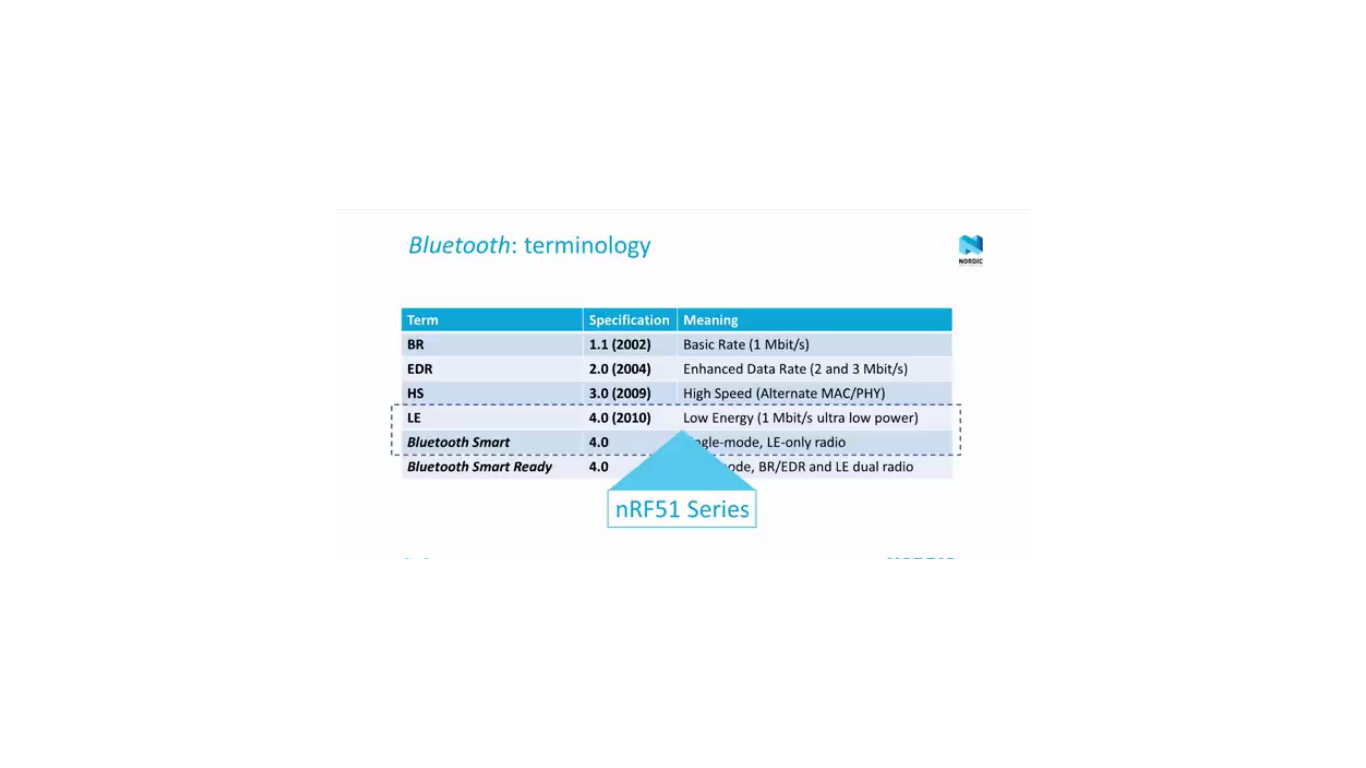

I'm referring this blog on getting started with nRF51822 and in this same blog, there is a link to a video by Nordic on Introduction to Bluetooth Smart and after watching it, (Please refer the video or the screenshot in the attachment), my understanding is that, nRF51 series (which means nRF51822QFAA SOC that I have) is not compliant with BLE 4.1 specification, which introduced dual mode (A bluetooth device that can act as central and peripheral at the same time), however with Softdevice S130, I should still be able to achieve this dual mode feature with NRF51822. Please confirm. Also, what are the limitations of Softdevice S130 (Nordic Bluetooth stack), when it comes to form a bluetooth mesh network for a connected topology, i.e. Capability for following BLE 4.1 features:
  • A device can act as a central and a peripheral at the same time.
  • A central can be connected to multiple peripherals.
  • A peripheral can be connected to multiple centrals.

    The S130 is compliant with BLE 4.1 (It is actually even compliant with 4.2)
    The S130 can do the following at the same time:
    • Connect to up to three peripherals
    • Connect to ONE central
    • Scan for BLE devices (Observer mode)
    • Advertise BLE packets (Broadcaster mode)
    have you tried to get the S130 working? One way to check if your chipset supports meshing is to take a look at my open source mesh implementation here ;-)
    github.com/.../fruitymesh
    Go to the wiki and open the Quick start page: github.com/.../Quick-Start
    Flashing the softdevice and fruitymesh will take you about 5 minutes and you can test real fast if your device will support meshing.
    Some more info about the connections:
    The S130 supports multiple peripheral connections but only one connection to a central. I do not know of any BLE stack that supports this, nor do I think that this will be implemented in the near future.
    A stack does not need to be able to connect to multiple centrals at the same time to e compliant with the 4.1 spec.
