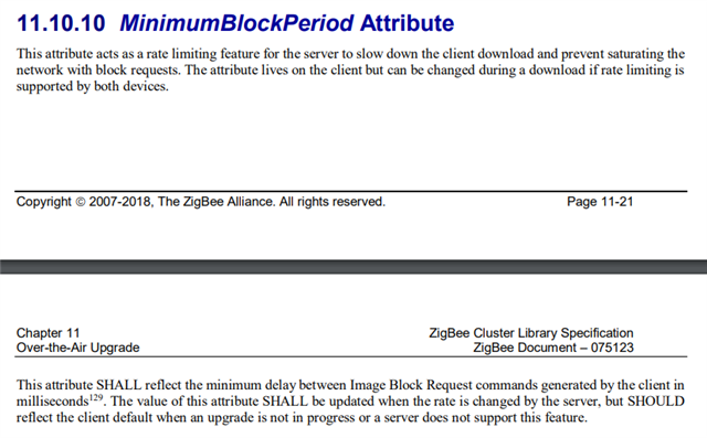

I'm using nRF5 SDK for Thread and Zigbee v4.2.0 and trying to test Zigbee OTA example.
I'm following this guide https://infocenter.nordicsemi.com/index.jsp?topic=%2Fsdk_tz_v4.2.0%2Fzigbee_example_ota_examples.html  and there was some troubles that where answered here nRF5 SDK for Thread and Zigbee OTA Example  .
Anyway it worked but the OTA process took me about 1 hour. I tried this example 4 times and the time is the same. In my opinion, this is too slow for a 270Kb package.
Is 1 hour OTA normal or did I just get something wrong?
Maybe I need to use a sniffer to see what errors are causing it to take such a long time. If so, what to look for?
