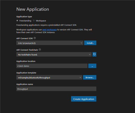

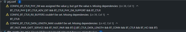

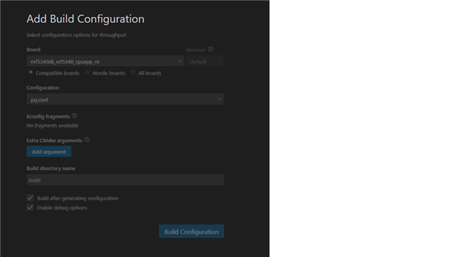

  • I have tried creating a new Freestanding application as-is using the "throughput" template but still getting the warnings.
    I have attached the template creation,  build cfg and build warnings screenshot  and config files for the sample application.
    Is this something issue with my toolchain installation or it is expected to be fixed during the dev based on the their env setups?

  • Looks like there is an issue with the vs code extension, if you build straight from the \v2.0.2\nrf\samples\bluetooth\throughput it compiles with no problems. In both cases the compiled hex file is identical, so I assume you can ignore the problem in this case. The vs code exension team is looking into it, and it should be fixed in next release (~month).
    Kenneth
