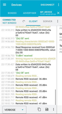

  • Hi Einar,
    I can confirm from the log in the nRF Connect mobile app and the terminal log (connected through VCOM) that the service fails to send data from the client to server when I start a macro (print RSSI every 1 sec) on the mobile app. Here are screenshots to explain:
    1. I can start the RSSI macro in the app. As you can see above it, there is a TX Power service (TPS).
    2. If I select the upload characteristic button under the TPS, I can send data:
    3. I can then see in the application log that data has been sent:
    4. I can confirm the data has been sent by the client as I can see confirmation that data has been receieved on the terminal log (server/peripheral side):
    Received data, handle 0, con 0x20001c00, data: 0x00
    Tx power set to 0
    5. If I start the RSSI macro, I can see RSSI measurements appearing in the app log:
    Now the problem begins. While RSSI is continually being printed in the log, any data that I attempt to send (client to server) does not send... I know this service fails as I get no confirmation of data sent on the application log or data received on the terminal log. As I said previously, if I stop the RSSI macro, everything works normally again.
    I would appreicate any help/suggestions regarding this issue please.
    Thanks very much,
    Adam
    I think this is not a bug, but a feature Slight smile
    When an operation is running, other commands cannot be started until the current operation ends. Waiting is just like any other command, so when you wait, you wait. Unfortunately, the UI and macros are using the same API under the hood, so that would require some changes in the app. You may record sending a new TX value in a macro in between RSSI requests, which should work.
