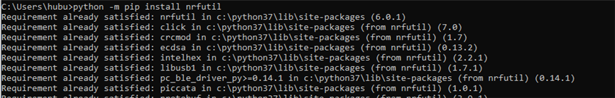

    Nordic provides nRFutil tool to generate these keys. nRFutil.exe can be downloaded from github here, the user guide is here.
    Or acquired from python using pip3 install nrfutil. To check for update, call pip3 install nrfutil --upgrade (or use python -m pip install nrfutil)
