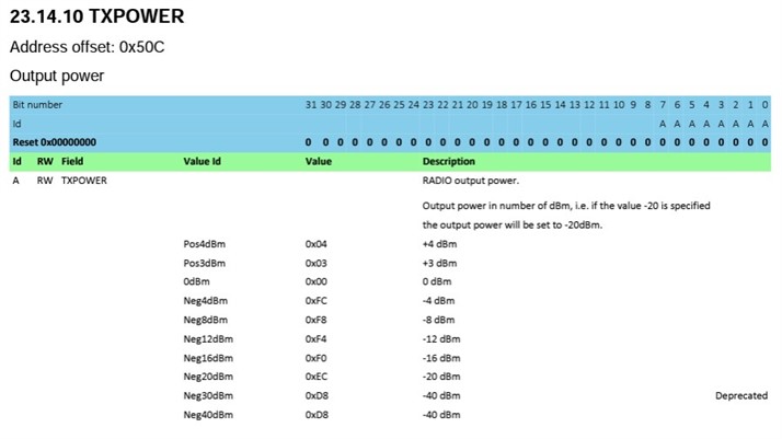

Is there any way to set BLE txpower to -30dbm etc. using nrf52832?
Hi, I am developing a product using BLE with nrf52832.
We are aiming for a BLE communication range of around 1.0m.
However, if txpower is set to -20dbm, BLE communication will be possible farther than expected.
So, I set txpower to -40dbm because the datasheet says that it can be set to -40dbm, but this time, BLE communication was possible only at a shorter distance than expected.
Is there any way to set txpower to -30dbm between -20 and -40?
Thank you very much in advance.
