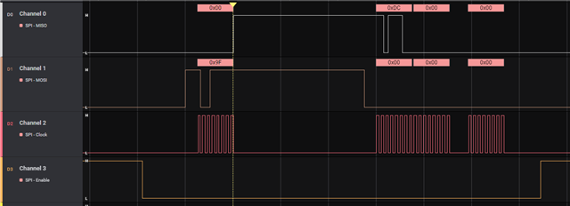

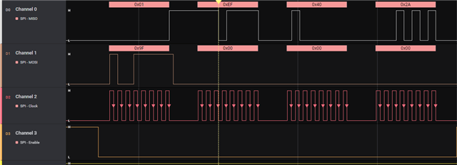

  • Hi
    Me and a colleague looked at your code, but it's very hard to spot something wrong by just looking at raw code, so we have not seen anything obviously wrong in your application. Can you upload a picture of the activity on your logic analyzer with a label of what line is what pin, right after a read JEDEC ID operation, from the Arduino and from an nRF52833. That way we can compare and find out where exactly things are going wrong.
    Simon
