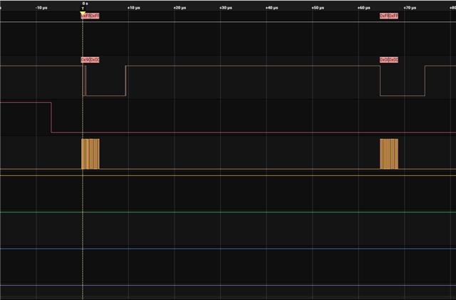

I am trying to interface winbond flash with the 33 board using ncs and VS code , I am able to get the code to compile and not receiving any errors , it is working and no matter what i send i am getting FF as a response
I have referred to Case ID: 261312
But As mentioned in the first link provided to change the .dts file . I cannot put in any pin configurations , if i do it is showing me a assert error for not having pin control in it , even when i try changing the pin numbers in the .overlay file I am getting the same issues .

  • Hi I can now get my cs pin to work and I am Unable to get any response from the flash , I tried implementing the flash with arduino and i can read the values stored in it , As per the data sheet i am trying to send 90h and then 000000h , where am i going wrong

  • Hi Simon , Yes I was not adding anything like this to my DT , I will try this out ,
    I am new to DTs and its functioning, Thank you for being patient
  • Hi Simon after making the necessary changes in my DT setting i still have not gotten it to work
    this is my dts spi3 setting
    arduino_spi: &spi3 {
    	status = "okay";
    	cs-gpios = <&gpio0  20 GPIO_ACTIVE_LOW>; /* D10 */
    	pinctrl-0 = <&spi3_default>;
    	pinctrl-1 = <&spi3_sleep>;
    	w25q16jv: w25q16jv@0 {
    		compatible = "jedec,spi-nor";
    		reg = <0>;
    		spi-max-frequency = <50000000>;
    		label = "w25q16jv";
    		jedec-id = [EF 70 16];
    		size = <16777216>;
  • Hi
    First thing I see is that you've set the SPI max frequency to 50 MHz, which is restricted to 8MHz for the SPI peripheral on the nRF52833.
    Do you have the datasheet of the w25q flash device you're using available? I don't see where you get EF 70 16 as the JEDEC ID from here: https://www.winbond.com/hq/support/documentation/levelOne.jsp?__locale=en&DocNo=DA00-W25Q16JV.1
    Are you also able to see some kind of return or error code now, or see where in the code it stops to give you an idea of what's wrong.
    Simon
