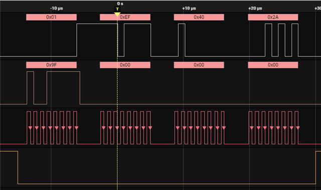

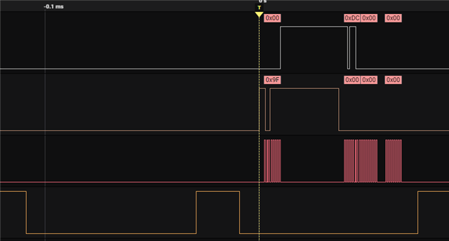

  • Hi
    Me and a colleague looked at your code, but it's very hard to spot something wrong by just looking at raw code, so we have not seen anything obviously wrong in your application. Can you upload a picture of the activity on your logic analyzer with a label of what line is what pin, right after a read JEDEC ID operation, from the Arduino and from an nRF52833. That way we can compare and find out where exactly things are going wrong.
    Simon
  • Hi Simon,
    Sorry for the late response , I was trying to figure it out , have now received some values from the flash but its not correct ,
    I want to try using CPOL=0 CPHA=1 because I tried it on another board and it was working fine , but when I try to implement it , I get -22 error which means that my previous write has not finished , but I am using only one transceive function to send all 4 bytes . I am attaching both captures of my Logic analyzer
    nrf board
