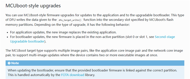

another question, 5340-audio can DFU?
Yes, this is possible. You can read more about the DFU support here.

2.form the link,i don' konw how to add DFU, is there have examples for it?
i konw hello_world project add DFU like follow:
thanks for reply, i will got it.

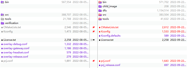

Hi
thanks for reply,
i've update v2.1.0, it can see dfu folder.
there will no overlay-gateway.conf and overlay-headset.conf
Best regards

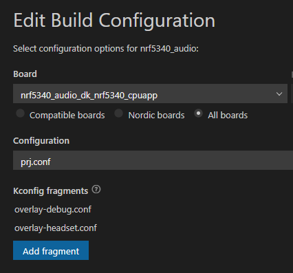

Hi
In order to change between headset and gateway you can set CONFIG_AUDIO_DEV in your prj.conf file.
Set it to 1 for headset and 2 for gateway, as described in the Kconfig file:
config AUDIO_DEV int "Select which device type to compile for. 1=HEADSET or 2=GATEWAY" range 1 2 default 1 help Setting this variable to 1 selects that the project is compiled as a HEADSET device. Setting to 2 will compile as a GATEWAY.
