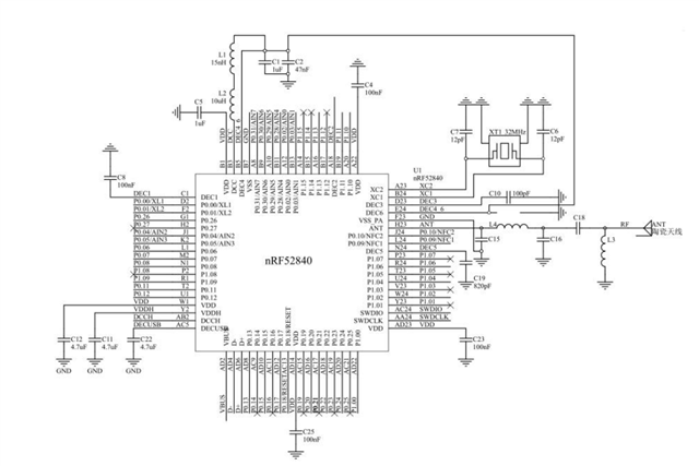

i build the zephyr samples/hello_world Demo ,and it can run and print well on BOARD_NRF52840DK_NRF52840.
but this hex file cannot boot up on my own board.
for simplest case, my own custom board only use 4 pins (SWC SWD GND VCC) from this www.aliexpress.com/wholesale
someone suggests set BOARD_ENABLE_DCDC=n but not work for me.
so i need some help
thx!

    kit j said:
    because there is no way to transmit 2.4G when XTAL=n
    This assumption is not quite correct. The Gazell, BLE and other 2.4 GHz protocol can run with RC oscillator. The only requirement is to have an external high frequency crystal.
    The schematic you shared only have an external high frequency crystal. It doesn't show an external low frequency crystal.
    regards
    Jared
