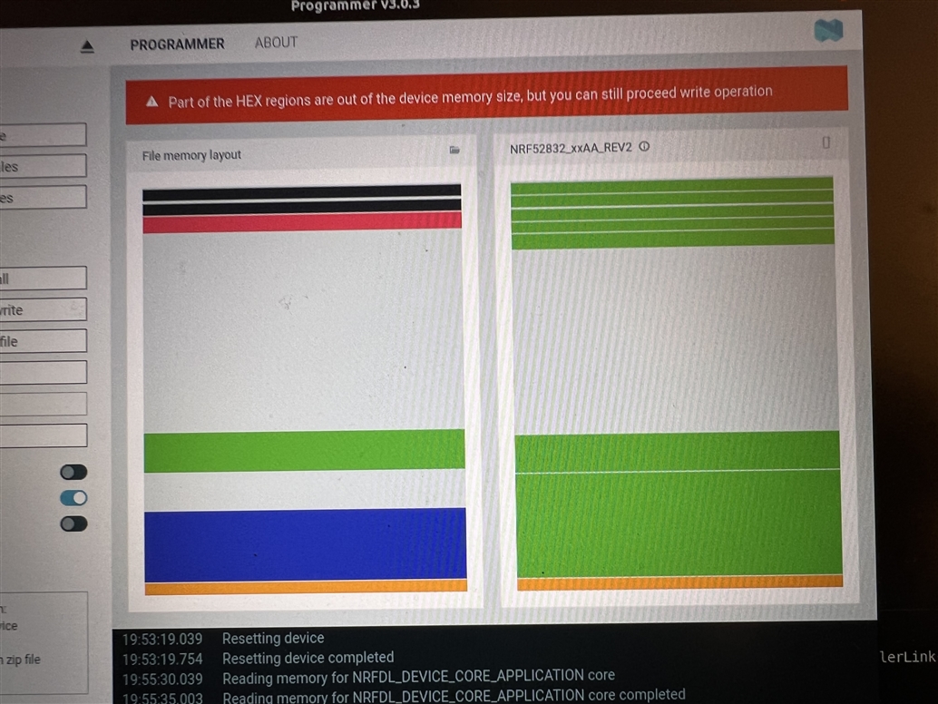

Issue: after successfully compiling, generating bootloader settings, merging and flashing bootloader+settings+sd+app, the device enters DFU mode while i was expecting to run the app.
I'm developing a solution based on a nRF52832 with a custom board, softdevice S112 version 7.0.2, with SDK 17.0.2.
I have successfully built the micro_eec library, and bootloader from $(SDK)/examples/dfu/secure_bootloader/pca10040e_s112_ble.
My app is tested working when flashing with no bootloader (erase device, flash the softdevice and app). My app also uses two flash pages to store data, as per this definition:

  • Hi Martin,
    Your choice of fstorage pages sticks out. Referring to the memory layout from the bootloader documentation you see that the bootloader settings page and MBR params page (latter is optional but needed for SoftDevice and bootloader updates) are fixed to the two last pages. So using the example bootloader, when you write other data to these pages from your application they will be corrupted. With a corrupt bootloader settings page, the bootloader will enter DFU mode instead of starting the application.
    I see that you have relocated the bootloader settings page and MBR params page in your bootloader linker file though, so at first glance the above is not the issue in your bootloader. However, there are also other parts of the code where the bootloader settings page address is defined. Specifically, the definition of BOOTLOADER_SETTINGS_ADDRESS and NRF_MBR_PARAMS_PAGE_ADDRESS in <nRF5 SDK 17.0.2>\components\libraries\bootloader\dfu\nrf_dfu_types.h. Have you adjusted that?
    (Generally, I would recommend placing your user data below the bootloader (and even below the FDS pages if you use that, as that is also hard coded to always be immediately below the bootloader) just because that is what is supported out of the box. Generally where you locate data should not matter, but changing as little as possible in the SDK code probably makes sense unless there are good reasons to do so.)

  • Hi Martin,
    Martin Buc said:
    First, i want to clarify that i did not make any changes in the bootloader linker script. All values shown in that file are the same as the ones stated in the bootloader documentation, under memory layout, but for the nRF52810 with S112.
    I'm on nRF52832 with S112, so it arises a couple of questions:
    I see. Then the problem is not that you modified the linker script, but that you are using one that does not match the IC you are using. The linker script you are using is for the nRF52810 (or other devices with 192 kB flash). As explained in my previous post the bootloader assumes that the special pages are located at the end of the flash, so with this linker script there will be a mismatch between where these are placed and where code expects to find it if you are using this with a nRF52832. So you need to pick the linker scripts form a nRF52832 project instead and most likely that will resolve the issue you are seeing.

    2) how do change a project (app and bootloader) to use nRF52832 with S112? i mean which defines and where do i need to update? do i have to change linker script by hand?
    For the application project, you need to adjust the start address (to the size of the SoftDevice you are using, refer to either a project that use this SoftDevice or the SoftDevice release notes). This is not needed for the bootloader. In both cases, you need to replace the header files for the SoftDevice with the one for your SoftDevice in your project (Makefile in your case). There is also a define defining the specific SoftDevice that needs to be changes. You can search through the Makefile for "S132" and "s132" and replace that with "S112" and "s112" respectively, and that should cover all. There is no need to change the linker script (just as long as you picked one from an example project for the same IC that you are using).
    Martin Buc said:
    When i change the CFLAGS/ASMFLAGS in the makefile of bootloader project from -DNRF52810_XXAA to -DNRF52832_XXAA, the compiler complains about nRF5_SDK_17.0.2_d674dde/modules/nrfx/mdk/system_nrf52810.c:133:16: error: 'NRF_CCM_Type' has no member named 'MAXPACKETSIZE'
    133 | NRF_CCM->MAXPACKETSIZE = 0xFBul;
    There are much more changes needed if you do it like this, start off with a nRF52832 project and modify it to use another SoftDevice in stead. This way only a few changes are needed (as explained above).

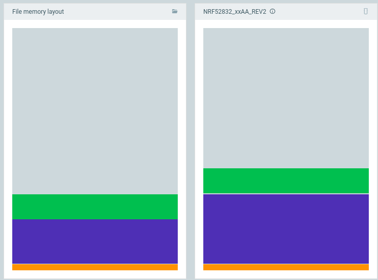

  • Hello Einar,
    For the bootloader i started using the example "nRF5_SDK_17.0.2_d674dde/examples/dfu/secure_bootloader/pca10040_s132_ble, and changed header files and definitions in order to use s112 softdevice.
    For the app project i took makefile and linker script from "nRF5_SDK_17.0.2_d674dde/examples/ble_peripheral/ble_app_uart/pca10040/s112/", and adapted the makefile for my project (just added support for float printf, crc32 and sdflash access). Here are those files i'm using for the app project:

    Another thing i noticed is a change in address from hex file compared with what is actually written on the flash, as you can see from the image below:
    On the left you can see sd+app as loaded into the programmer software. On the right, you can find the actual read memory of the device, after writing the same exact files show on the left panel.
    To write i use nrfjprog, as you can tell from flash commands at the end of the makefile posted above.
    Thanks again, i really appreciate your help.
