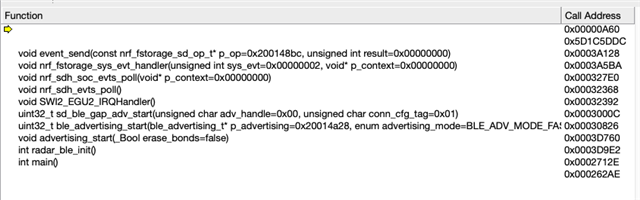

Hi I have done that, my firmware halts at this point:
thought your suggestion on the flash writes might be right since it doesn't happen if I don't erase all data
That is odd. Alternatively then you can look at what happens before, where you are writing to flash via fstorage. Could it be that some pointer values are wrong for some reason? Are you basing something upon data that will be but have not yet been written to flash, or something else? If it is difficult to find it by inspection, and you cannot get the hardfault handler working, then a third alternative could be to comment out parts of your code and gradually include more to narrow down the problematic part.
okay I will try some of these things but I have already gone through these things and the problem is that the hardfault happens on an SVCall. Therefore I can only go to '
sd_ble_gap_adv_start
' and not any further. I am using the peer manager btw so this is something that could fail as well maybe? I am not writing to storage before starting the advertising so this is strange to me as well. will go through some data that goes into the advertising_init structure but I don't think its a problem in there.

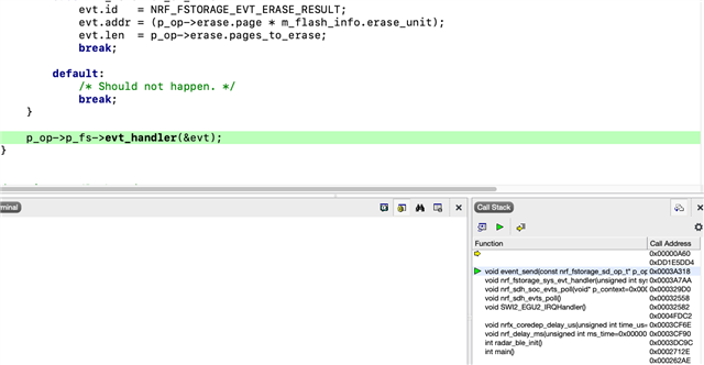

So I found out it doesnt actually happen at that SVCALL but rather somewhere before (I just put in a delay before starting my advertising) and got the hardfault at that place. How do I find out whats written in the triggered event?:
thanks for your help already, I appreciate your quick responses!
Can you try again to get the hardfault handler working? Without it, perhaps ti would make sense to try to log or inspect the parameters you provide to fstorage. Could there be corrupt pointers, for instance? Coming from some data that is stored in flash (as you see changes after a certain number of resets, these changes must be stored in something persistent, like flash)?
