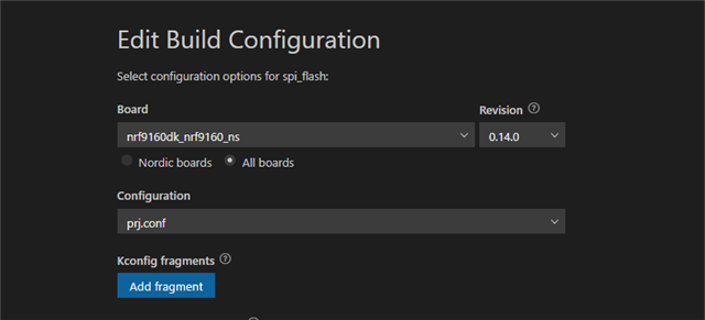

  • I just tested the sample spi_flash with the board selection nrf9160dk_nrf9160_ns v0.14.0 (that revision will enable external flash) and NCS v2.0.0.
    I used the board nRF9160 DK v1.0.1
    I also created a file \zephyr\samples\drivers\spi_flash\boards\nrf9160dk_nrf9160_ns.conf and added CONFIG_SPI_NOR=y.
    I got the following output:
    *** Booting Zephyr OS build v3.0.99-ncs1  ***
    JEDEC SPI-NOR SPI flash testing
    Test 1: Flash erase
    Flash erase succeeded!
    Test 2: Flash write
    Attempting to write zu bytes
    Data read matches data written. Good!!
    Which means that I'm successfully able to read and write to external flash using the API zephyr/drivers/flash.h
    I see now that you're using NCS v1.6.0. Let me know if the above works on that version too.
