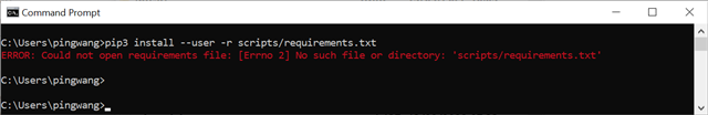

    2. I am stuck in generating new key pair, it seems like I need to install the image tool first according to the link , I opened cmd window and tried following and got a error message below. Sorry, I am not familiar with python, and need more help here to install the tool. I am a windows user.
    Could you help further please?
    Ping
  • Hello Ping,
    The imgtool is included in the SDK toolchain. Try to open the terminal from the Toolchain manager app, then run 'imgtool' from the terminal to verify that it is installed.
