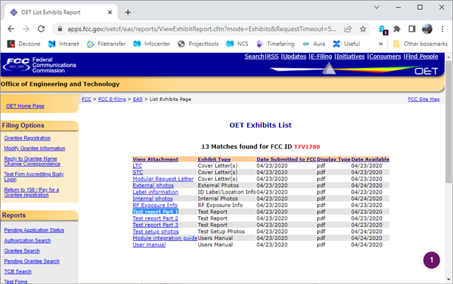

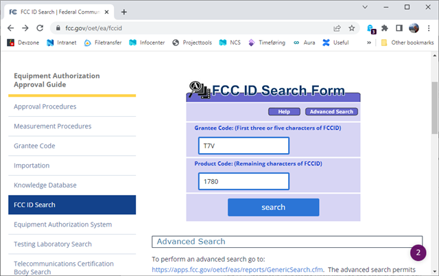

    I did a search on the fcc id used here:
    And did find in the test report:
    That they have stated SD140 and SD113 in the FCC listing.
    Based on this I agree with you and them that you will need to use those two specific softdevices. However for all pratical purposes this is nitpicking, because both the S140 and softdevice controller in ncs do state for instance Bluetooth 5.1 compliance, so they are the same.
