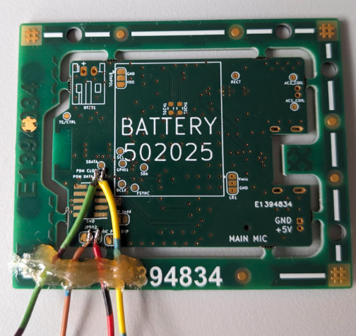

PDM clock is at 3.072 MHz (as 64X @ 48K) and ACLK clock source at 12.288 MHz. This yields the proper sampling speed. However it seems that the rising edge of the clock is glitchy at random intervals (we can't identify whether this  means 0 samples or some other bit errors, the glitch repeat at around 100ms intervals sounds like static clicking with varied amplitude). We have tested 3 boards and swapped the microphones from left to right to check that it is not the routing on the pcb or the microphones. Glitch stayed always on the rising clock edge. We even tried different IO voltages to rule that out as well 1.8V and 2.3V were tried.
Interestingly the falling edge sampling of the clock works perfectly. (we have muted the other channel to see).

  • Ohh one more thing, we have changed the PDM to I2S converter to output the same 3.072MHz (it was default to 32X), and the microphone streams over I2S still worked perfectly.
    Also we have tested grounding the PDM data pin while it was running and that caused silence on both channels no glitches heard.
    And we have changed the clock IO driving strength as well, on the scope the clock and data both looked pristine, very fast rising and falling edges on both.

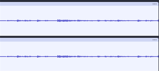

    Some scope pics:
    16kHz high pin drive
    48kHz high drive
    48kHz normal drive (original code)
    As you can see we have changed also the pin drive strength to reduce the rise/fall times, since our microphones have a specified maximum 12ns (your ST microphones didn't specify that) and even the high drive is slightly out at 14-15ns. I don't have a measurement of that from the PDM3140 yet, and I think it shouldn't really matter, but who knows. This is still an unverified action point for me, because if I cannot reach the desired rise/fall times, I'll have to add more hardware to the board to test.

    I have jumped on the opportunity to address this one more time when they guys visited us. So the way we have worked around currently is not to use 48k sampling on the pdm, but rather 16k. This cost us in SNR 3-5dB.
    The problem is with those microphones I sent you (we have those on our hardware versions since the v1.0) is that when PDM is used from the NRF5340 with 48k 16bit stereo (like the usb audio example does), one of the channels has a continuous random clicking noise (bad samples). The github repo above was the most minimalistic example I created, works with the nrf5340 dk and shows the symptoms on the usb audio recording. Same mics were unaffected in the same mode when external converters were used to PDM 2 I2S, we even used on 2 separate builds - 2 different converters, none showed this behavior.
