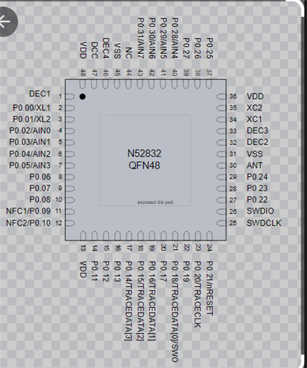

I'm currently developing with a nrf52832 (QFABB0) and I have to use pins 16,38,37 and 17 as gpio.
The problem is that when I have an error for pins greater than 32:

I cannot find anything to change the pin count to 48 (the number of pin on the chip) in the SDK.
Here is the code I'm using to set pins (pins number are specified in the Pin enum):

    How could I fix this issue ? Should I define P1_PIN_NUM and NRF_P1 (and how to find the correct values) ?
    Thank you
  • Susheel Nuguru said:
    I am not sure if that revision chip have 48 gpio pins, but if you think they do,
    Are you sure that the nrf52832 revision you are using have 48 gpios? I cannot see that any version of nrf52832 have more than one port (32 gpios).
  • Yes, I have counted the pins on the chip and there is 48 pins.
    Is there another way of fixing the problem ?
    Thank you
  • Seems like there is no direct supported variant from us for that chip version. I will try to patch the files and attach here tomorrow. Thanks for your patience.
