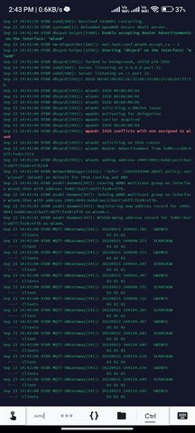

    I have used fresh SDK and fresh OTBR image running on RPi 3B+ from Nordic. Currently running MQttsn publisher example for test.
    Nrf52840 dk board get connected to thread network but when I search for gateway by pressing button 1 the gateway is not found. This happens with fresh SDK, fresh OTBR image from Nordic.
    On OTBR side, when I see log I can see the GWSearch packet and gateway search pack being sent to client. But my node is unable to connect to gateway.
    Every system service is running and also tried restarting the mqtt-sn gateway. Still not able to connect to gateway.
    Can you please tell what to do ?

    Here is the log of OTBR by running journalctl -ef:
    In the below file you can see client has tried searching for gateway and search gateway info is also sent back to the client but client is unable to receive gateway data,
    ep 22 16:28:51 OTBR kernel: IPv6: ADDRCONF(NETDEV_CHANGE): nat64: link becomes ready
    Sep 22 16:28:51 OTBR tayga[717]: starting TAYGA 0.9.2
    Sep 22 16:28:51 OTBR tayga[717]: Using tun device nat64 with MTU 1500
    Sep 22 16:28:51 OTBR tayga[717]: TAYGA's IPv4 address: 192.168.255.1
    Sep 22 16:28:51 OTBR tayga[717]: TAYGA's IPv6 address: fdaa:bb:1::1
    Sep 22 16:28:51 OTBR tayga[717]: NAT64 prefix: 64:ff9b::/96
    Sep 22 16:28:51 OTBR NetworkManager[373]: <info>  [1663844331.3391] device (nat64): state change: ip-config -> ]
    Sep 22 16:28:51 OTBR tayga[717]: Note: traffic between IPv6 hosts and private IPv4 addresses (i.e. to/from 64:f.
    Sep 22 16:28:51 OTBR tayga[717]: Dynamic pool: 192.168.255.0/24
    Sep 22 16:28:51 OTBR NetworkManager[373]: <info>  [1663844331.3587] device (nat64): state change: ip-check -> s]
    Sep 22 16:28:51 OTBR named[454]: listening on IPv6 interface wlan0, fe80::ba27:ebff:fe9b:d1f4%3#53
    Sep 22 16:28:51 OTBR NetworkManager[373]: <info>  [1663844331.3655] device (nat64): state change: secondaries -]
    Sep 22 16:28:51 OTBR named[454]: could not listen on UDP socket: address not available
    Sep 22 16:28:51 OTBR named[454]: creating IPv6 interface wlan0 failed; interface ignored
    Sep 22 16:28:51 OTBR named[454]: listening on IPv6 interface nat64, fe80::de2f:4687:ea43:c66e%5#53
    Sep 22 16:28:51 OTBR tayga[717]: Loaded 1 dynamic map from /var/spool/tayga/dynamic.map
    Sep 22 16:28:51 OTBR named[454]: received control channel command 'reconfig'
    Sep 22 16:28:51 OTBR named[454]: loading configuration from '/etc/bind/named.conf'
    Sep 22 16:28:51 OTBR named[454]: reading built-in trusted keys from file '/etc/bind/bind.keys'
    Sep 22 16:28:51 OTBR named[454]: initializing GeoIP Country (IPv4) (type 1) DB
    Sep 22 16:28:51 OTBR named[454]: GEO-106FREE 20170512 Bu
    Sep 22 16:28:51 OTBR named[454]: initializing GeoIP Country (IPv6) (type 12) DB
    Sep 22 16:28:51 OTBR named[454]: GeoIP City (IPv4) (type 2) DB not available
    Sep 22 16:28:51 OTBR named[454]: GeoIP City (IPv4) (type 6) DB not available
    Sep 22 16:28:51 OTBR NetworkManager[373]: <info>  [1663844331.4123] device (nat64): Activation: successful, dev.
    Sep 22 16:28:51 OTBR named[454]: GeoIP City (IPv6) (type 30) DB not available
    Sep 22 16:28:51 OTBR named[454]: GeoIP City (IPv6) (type 31) DB not available
    Sep 22 16:28:51 OTBR named[454]: GeoIP Region (type 3) DB not available
    Sep 22 16:28:51 OTBR named[454]: GeoIP Region (type 7) DB not available
    Sep 22 16:28:51 OTBR named[454]: GeoIP ISP (type 4) DB not available
    Sep 22 16:28:51 OTBR named[454]: GeoIP Org (type 5) DB not available
    Sep 22 16:28:51 OTBR named[454]: GeoIP AS (type 9) DB not available
    Sep 22 16:28:51 OTBR named[454]: GeoIP Domain (type 11) DB not available
    Sep 22 16:28:51 OTBR systemd[1]: Reloading OpenBSD Secure Shell server.
    Sep 22 16:28:51 OTBR named[454]: GeoIP NetSpeed (type 10) DB not available
    Sep 22 16:28:51 OTBR named[454]: using default UDP/IPv4 port range: [32768, 60999]
    Sep 22 16:28:51 OTBR named[454]: using default UDP/IPv6 port range: [32768, 60999]
    Sep 22 16:28:51 OTBR named[454]: sizing zone task pool based on 5 zones
    Sep 22 16:28:51 OTBR named[454]: dns64 reverse zone: 0.0.0.0.0.0.0.0.0.0.0.0.0.0.0.0.b.9.f.f.4.6.0.0.ip6.arpa.
    Sep 22 16:28:51 OTBR named[454]: using built-in root key for view _default
    Sep 22 16:28:51 OTBR named[454]: configuring command channel from '/etc/bind/rndc.key'
    Sep 22 16:28:51 OTBR named[454]: zone 0.0.0.0.0.0.0.0.0.0.0.0.0.0.0.0.b.9.f.f.4.6.0.0.ip6.arpa/IN: (master) remd
    Sep 22 16:28:51 OTBR named[454]: additionally listening on IPv6 interface wlan0, fe80::ba27:ebff:fe9b:d1f4%3#53
    Sep 22 16:28:51 OTBR named[454]: reloading configuration succeeded
    Sep 22 16:28:51 OTBR named[454]: any newly configured zones are now loaded
    Sep 22 16:28:51 OTBR nm-dispatcher[597]: req:3 'up' [nat64]: new request (3 scripts)
    Sep 22 16:28:51 OTBR sshd[474]: Received SIGHUP; restarting.
    Sep 22 16:28:51 OTBR systemd[1]: Reloaded OpenBSD Secure Shell server.
    Sep 22 16:28:51 OTBR dhcpv6-helper[735]: Enable accepting Router Advertisements on the interface: 'wlan0'
    Sep 22 16:28:51 OTBR nm-dispatcher[597]: net.ipv6.conf.wlan0.accept_ra = 2
    Sep 22 16:28:51 OTBR dhcpv6-helper[737]: Starting 'dhcpcd' on the interface: 'wlan0'
    Sep 22 16:28:51 OTBR sshd[474]: Server listening on 0.0.0.0 port 22.
    Sep 22 16:28:51 OTBR sshd[474]: Server listening on :: port 22.
    Sep 22 16:28:51 OTBR dhcpcd[738]: forked to background, child pid 739
    Sep 22 16:28:51 OTBR nm-dispatcher[597]: sed: can't read /tmp/dhcpcd_interfaces: No such file or directory
    Sep 22 16:28:51 OTBR nm-dispatcher[597]: req:3 'up' [nat64]: start running ordered scripts...
    Sep 22 16:28:51 OTBR dhcpcd[739]: DUID 00:01:00:01:26:32:09:39:b8:27:eb:b1:ff:fb
    Sep 22 16:28:51 OTBR dhcpcd[739]: wlan0: IAID 00:00:00:04
    Sep 22 16:28:51 OTBR dhcpcd[739]: wlan0: IAID 00:00:00:05
    Sep 22 16:28:51 OTBR dhcpcd[739]: wlan0: IAID 00:00:00:06
    Sep 22 16:28:52 OTBR sshd[474]: Received SIGHUP; restarting.
    Sep 22 16:28:52 OTBR systemd[1]: Reloaded OpenBSD Secure Shell server.
    Sep 22 16:28:52 OTBR sshd[474]: Server listening on 0.0.0.0 port 22.
    Sep 22 16:28:52 OTBR sshd[474]: Server listening on :: port 22.
    Sep 22 16:28:52 OTBR named[454]: received control channel command 'reconfig'
    Sep 22 16:28:52 OTBR named[454]: loading configuration from '/etc/bind/named.conf'
    Sep 22 16:28:52 OTBR dhcpcd[739]: wlan0: soliciting an IPv6 router
    Sep 22 16:28:52 OTBR named[454]: reading built-in trusted keys from file '/etc/bind/bind.keys'
    Sep 22 16:28:52 OTBR named[454]: initializing GeoIP Country (IPv4) (type 1) DB
    Sep 22 16:28:52 OTBR named[454]: GEO-106FREE 20170512 Bu
    Sep 22 16:28:52 OTBR named[454]: initializing GeoIP Country (IPv6) (type 12) DB
    Sep 22 16:28:52 OTBR named[454]: GeoIP City (IPv4) (type 2) DB not available
    Sep 22 16:28:52 OTBR named[454]: GeoIP City (IPv4) (type 6) DB not available
    Sep 22 16:28:52 OTBR named[454]: GeoIP City (IPv6) (type 30) DB not available
    Sep 22 16:28:52 OTBR named[454]: GeoIP City (IPv6) (type 31) DB not available
    Sep 22 16:28:52 OTBR named[454]: GeoIP Region (type 3) DB not available
    Sep 22 16:28:52 OTBR named[454]: GeoIP Region (type 7) DB not available
    Sep 22 16:28:52 OTBR named[454]: GeoIP ISP (type 4) DB not available
    Sep 22 16:28:52 OTBR named[454]: GeoIP Org (type 5) DB not available
    Sep 22 16:28:52 OTBR named[454]: GeoIP AS (type 9) DB not available
    Sep 22 16:28:52 OTBR named[454]: GeoIP Domain (type 11) DB not available

    Sep 22 16:29:04 OTBR avahi-daemon[377]: Joining mDNS multicast group on interface wlan0.IPv4 with address 192.1.
    Sep 22 16:29:04 OTBR NetworkManager[373]: <info>  [1663844344.5143] dhcp4 (wlan0):   nameserver '8.8.8.8'
    Sep 22 16:29:04 OTBR avahi-daemon[377]: New relevant interface wlan0.IPv4 for mDNS.
    Sep 22 16:29:04 OTBR NetworkManager[373]: <info>  [1663844344.5144] dhcp4 (wlan0):   nameserver '4.2.2.2'
    Sep 22 16:29:04 OTBR avahi-daemon[377]: Registering new address record for 192.168.0.3 on wlan0.IPv4.
    Sep 22 16:29:04 OTBR NetworkManager[373]: <info>  [1663844344.5145] dhcp4 (wlan0):   domain name 'domain.name'
    Sep 22 16:29:04 OTBR named[454]: listening on IPv4 interface wlan0, 192.168.0.3#53
    Sep 22 16:29:04 OTBR NetworkManager[373]: <info>  [1663844344.5147] dhcp4 (wlan0): state changed unknown -> boud
    Sep 22 16:29:04 OTBR named[454]: listening on IPv6 interface wlan0, fe80::ba27:ebff:fe9b:d1f4%3#53
    Sep 22 16:29:04 OTBR NetworkManager[373]: <info>  [1663844344.5321] device (wlan0): state change: ip-config -> ]
    Sep 22 16:29:04 OTBR named[454]: could not listen on UDP socket: address not available
    Sep 22 16:29:04 OTBR NetworkManager[373]: <info>  [1663844344.5380] device (wlan0): state change: ip-check -> s]
    Sep 22 16:29:04 OTBR named[454]: creating IPv6 interface wlan0 failed; interface ignored
    Sep 22 16:29:04 OTBR NetworkManager[373]: <info>  [1663844344.5416] device (wlan0): state change: secondaries -]
    Sep 22 16:29:04 OTBR dhclient[1036]: bound to 192.168.0.3 -- renewal in 3132 seconds.
    Sep 22 16:29:04 OTBR NetworkManager[373]: <info>  [1663844344.5427] manager: NetworkManager state is now CONNECL
    Sep 22 16:29:04 OTBR nm-dispatcher[597]: req:6 'connectivity-change': new request (3 scripts)
    Sep 22 16:29:04 OTBR nm-dispatcher[597]: req:6 'connectivity-change': start running ordered scripts...
    Sep 22 16:29:04 OTBR ap-helper[1047]: Unsupported action: 'connectivity-change'
    Sep 22 16:29:04 OTBR dhcpv6-helper[1049]: Unsupported action: 'connectivity-change'
    Sep 22 16:29:04 OTBR NetworkManager[373]: <info>  [1663844344.5990] manager: NetworkManager state is now CONNECL
    Sep 22 16:29:04 OTBR NetworkManager[373]: <info>  [1663844344.6006] policy: set 'NetweeN' (wlan0) as default foS
    Sep 22 16:29:04 OTBR NetworkManager[373]: <info>  [1663844344.6012] dns-mgr: Writing DNS information to /sbin/rf
    Sep 22 16:29:04 OTBR NetworkManager[373]: Too few arguments.
    Sep 22 16:29:04 OTBR NetworkManager[373]: <info>  [1663844344.7919] device (wlan0): Activation: successful, dev.
    Sep 22 16:29:04 OTBR nm-dispatcher[597]: req:7 'up' [wlan0]: new request (3 scripts)
    Sep 22 16:29:04 OTBR nm-dispatcher[597]: req:7 'up' [wlan0]: start running ordered scripts...
    Sep 22 16:29:04 OTBR named[454]: received control channel command 'reconfig'
    Sep 22 16:29:04 OTBR named[454]: loading configuration from '/etc/bind/named.conf'
    Sep 22 16:29:05 OTBR named[454]: reading built-in trusted keys from file '/etc/bind/bind.keys'
    Sep 22 16:29:05 OTBR named[454]: initializing GeoIP Country (IPv4) (type 1) DB
    Sep 22 16:29:05 OTBR named[454]: GEO-106FREE 20170512 Bu
    Sep 22 16:29:05 OTBR named[454]: initializing GeoIP Country (IPv6) (type 12) DB
    Sep 22 16:29:05 OTBR named[454]: GeoIP City (IPv4) (type 2) DB not available
    Sep 22 16:29:05 OTBR named[454]: GeoIP City (IPv4) (type 6) DB not available
    Sep 22 16:29:05 OTBR named[454]: GeoIP City (IPv6) (type 30) DB not available
    Sep 22 16:29:05 OTBR named[454]: GeoIP City (IPv6) (type 31) DB not available
    Sep 22 16:29:05 OTBR named[454]: GeoIP Region (type 3) DB not available
    Sep 22 16:29:05 OTBR named[454]: GeoIP Region (type 7) DB not available
    Sep 22 16:29:05 OTBR named[454]: GeoIP ISP (type 4) DB not available
    Sep 22 16:29:05 OTBR named[454]: GeoIP Org (type 5) DB not available
    Sep 22 16:29:05 OTBR named[454]: GeoIP AS (type 9) DB not available
    Sep 22 16:29:05 OTBR named[454]: GeoIP Domain (type 11) DB not available
    Sep 22 16:29:05 OTBR named[454]: GeoIP NetSpeed (type 10) DB not available
    Sep 22 16:29:05 OTBR named[454]: using default UDP/IPv4 port range: [32768, 60999]
    Sep 22 16:29:05 OTBR named[454]: using default UDP/IPv6 port range: [32768, 60999]
    Sep 22 16:29:05 OTBR named[454]: listening on IPv6 interface wlan0, fe80::ba27:ebff:fe9b:d1f4%3#53
    Sep 22 16:29:05 OTBR named[454]: could not listen on UDP socket: address not available
    Sep 22 16:29:05 OTBR named[454]: creating IPv6 interface wlan0 failed; interface ignored
    Sep 22 16:29:05 OTBR named[454]: sizing zone task pool based on 5 zones
    Sep 22 16:29:05 OTBR named[454]: dns64 reverse zone: 0.0.0.0.0.0.0.0.0.0.0.0.0.0.0.0.b.9.f.f.4.6.0.0.ip6.arpa.
    Sep 22 16:29:05 OTBR named[454]: using built-in root key for view _default
    Sep 22 16:29:05 OTBR named[454]: configuring command channel from '/etc/bind/rndc.key'
    Sep 22 16:29:05 OTBR named[454]: zone 0.0.0.0.0.0.0.0.0.0.0.0.0.0.0.0.b.9.f.f.4.6.0.0.ip6.arpa/IN: (master) remd
    Sep 22 16:29:05 OTBR named[454]: additionally listening on IPv6 interface wlan0, fe80::ba27:ebff:fe9b:d1f4%3#53
    Sep 22 16:29:05 OTBR named[454]: reloading configuration succeeded
    Sep 22 16:29:05 OTBR named[454]: any newly configured zones are now loaded
    Sep 22 16:29:05 OTBR systemd[1]: Reloading OpenBSD Secure Shell server.
    Sep 22 16:29:05 OTBR sshd[474]: Received SIGHUP; restarting.
    Sep 22 16:29:05 OTBR systemd[1]: Reloaded OpenBSD Secure Shell server.
    Sep 22 16:29:05 OTBR dhcpv6-helper[1133]: Enable accepting Router Advertisements on the interface: 'wlan0'
    Sep 22 16:29:05 OTBR nm-dispatcher[597]: net.ipv6.conf.wlan0.accept_ra = 2
    Sep 22 16:29:05 OTBR dhcpv6-helper[1135]: Starting 'dhcpcd' on the interface: 'wlan0'
    Sep 22 16:29:05 OTBR dhcpcd[1136]: forked to background, child pid 1137
    Sep 22 16:29:05 OTBR sshd[474]: Server listening on 0.0.0.0 port 22.
    Sep 22 16:29:05 OTBR sshd[474]: Server listening on :: port 22.
    Sep 22 16:29:05 OTBR dhcpcd[1137]: DUID 00:01:00:01:26:32:09:39:b8:27:eb:b1:ff:fb
    Sep 22 16:29:05 OTBR dhcpcd[1137]: wlan0: IAID 00:00:00:04
    Sep 22 16:29:05 OTBR dhcpcd[1137]: wlan0: IAID 00:00:00:05
    Sep 22 16:29:05 OTBR dhcpcd[1137]: wlan0: IAID 00:00:00:06
    Sep 22 16:29:05 OTBR dhcpcd[1137]: wlan0: soliciting an IPv6 router
    Sep 22 16:29:06 OTBR avahi-daemon[377]: Joining mDNS multicast group on interface wlan0.IPv6 with address fe80:.
    Sep 22 16:29:06 OTBR dhcpcd[1137]: wlan0: soliciting a DHCPv6 lease
    Sep 22 16:29:06 OTBR avahi-daemon[377]: New relevant interface wlan0.IPv6 for mDNS.
    Sep 22 16:29:06 OTBR avahi-daemon[377]: Registering new address record for fe80::ba27:ebff:fe9b:d1f4 on wlan0.*.
    Sep 22 16:29:06 OTBR dhcpcd[1137]: wpan0: activating for delegation
    Sep 22 16:29:06 OTBR named[454]: listening on IPv6 interface wlan0, fe80::ba27:ebff:fe9b:d1f4%3#53
    Sep 22 16:29:06 OTBR dhcpcd[1137]: wpan0: carrier acquired
    Sep 22 16:29:06 OTBR dhcpcd[1137]: wpan0: IAID 00:00:00:04
    Sep 22 16:29:06 OTBR dhcpcd[1137]: wpan0: IAID conflicts with one assigned to wlan0
    Sep 22 16:29:06 OTBR sudo[868]: pam_unix(sudo:session): session closed for user root
    Sep 22 16:29:06 OTBR dhcpcd[1137]: wlan0: Router Advertisement from fe80::928d:78ff:fe76:2700
    Sep 22 16:29:06 OTBR NetworkManager[373]: <info>  [1663844346.5833] policy: set 'NetweeN' (wlan0) as default foS
    Sep 22 16:29:17 OTBR systemd[859]: Time has been changed
    Sep 22 16:29:17 OTBR systemd[1]: Time has been changed
    Sep 22 16:29:17 OTBR systemd-timesyncd[280]: Synchronized to time server 192.46.211.253:123 (2.debian.pool.ntp..
    Sep 22 16:29:17 OTBR systemd[1]: apt-daily-upgrade.timer: Adding 8min 32.320501s random time.
    Sep 22 16:29:17 OTBR systemd[1]: apt-daily.timer: Adding 53min 24.085739s random time.
    Sep 22 16:29:47 OTBR login[676]: pam_unix(login:session): session opened for user pi by LOGIN(uid=0)
    Sep 22 16:29:47 OTBR systemd-logind[331]: New session c2 of user pi.
    Sep 22 16:29:47 OTBR systemd[1]: Started Session c2 of user pi.
    Sep 22 16:29:48 OTBR sudo[1204]:       pi : TTY=serial0 ; PWD=/etc/mosquitto/conf.d ; USER=root ; COMMAND=/bin/3
    Sep 22 16:29:48 OTBR sudo[1204]: pam_unix(sudo:session): session opened for user root by (uid=0)
    Sep 22 16:29:48 OTBR sudo[1204]: pam_unix(sudo:session): session closed for user root
    Sep 22 16:30:11 OTBR CRON[1214]: pam_unix(cron:session): session opened for user root by (uid=0)
    Sep 22 16:30:11 OTBR CRON[1215]: pam_unix(cron:session): session opened for user pi by (uid=0)
    Sep 22 16:30:11 OTBR CRON[1222]: (pi) CMD (/home/pi/Autorun/reboot_wpan0.sh )
    Sep 22 16:30:11 OTBR CRON[1223]: (root) CMD (/home/pi/Autorun/reboot_wpan0sh >> /home/pi/rtxt.txt)
    Sep 22 16:30:11 OTBR CRON[1214]: (CRON) info (No MTA installed, discarding output)
    Sep 22 16:30:11 OTBR CRON[1215]: (CRON) info (No MTA installed, discarding output)
    Sep 22 16:30:11 OTBR CRON[1214]: pam_unix(cron:session): session closed for user root
    Sep 22 16:30:11 OTBR CRON[1215]: pam_unix(cron:session): session closed for user pi
    Sep 22 16:30:19 OTBR MQTT-SNGateway[503]:  *********************************************************************
    Sep 22 16:30:19 OTBR MQTT-SNGateway[503]:  * MQTT-SN Gateway
    Sep 22 16:30:19 OTBR MQTT-SNGateway[503]:  * Part of Project Paho in Eclipse
    Sep 22 16:30:19 OTBR MQTT-SNGateway[503]:  * (http://git.eclipse.org/c/paho/org.eclipse.paho.mqtt-sn.embedded-c)
    Sep 22 16:30:19 OTBR MQTT-SNGateway[503]:  * Author : Tomoaki YAMAGUCHI
    Sep 22 16:30:19 OTBR MQTT-SNGateway[503]:  * Version: 1.5.1
    Sep 22 16:30:19 OTBR MQTT-SNGateway[503]: 20220922 162842.850 PahoGateway-01 has been started.
    Sep 22 16:30:19 OTBR MQTT-SNGateway[503]:  ConfigFile: /etc/paho-mqtt-sn-gateway.conf
    Sep 22 16:30:19 OTBR MQTT-SNGateway[503]:  SensorN/W:   Gateway Port: 47193 Broadcast Address: ff33:40:fdde:ad05
    Sep 22 16:30:19 OTBR MQTT-SNGateway[503]:  Broker:     103.238.13.202 : 1883, 8883
    Sep 22 16:30:19 OTBR MQTT-SNGateway[503]:  Max number of Clients: 10000
    Sep 22 16:30:19 OTBR MQTT-SNGateway[503]:  RootCApath: (null)
    Sep 22 16:30:19 OTBR MQTT-SNGateway[503]:  RootCAfile: (null)
    Sep 22 16:30:19 OTBR MQTT-SNGateway[503]:  CertKey:    (null)
    Sep 22 16:30:19 OTBR MQTT-SNGateway[503]:  PrivateKey: (null)
    Sep 22 16:30:19 OTBR MQTT-SNGateway[503]: 20220922 162853.465   SEARCHGW          <---  Client                 1
    Sep 22 16:30:19 OTBR MQTT-SNGateway[503]: 20220922 162853.465   GWINFO            --->  Clients                1
    Sep 22 16:30:19 OTBR MQTT-SNGateway[503]: 20220922 162859.740   SEARCHGW          <---  Client                 1
    Sep 22 16:30:19 OTBR MQTT-SNGateway[503]: 20220922 162859.740   GWINFO            --->  Clients                1
    Sep 22 16:30:19 OTBR MQTT-SNGateway[503]: 20220922 162904.353   SEARCHGW          <---  Client                 1
    Sep 22 16:30:19 OTBR MQTT-SNGateway[503]: 20220922 162904.353   GWINFO            --->  Clients                1
    Sep 22 16:30:19 OTBR MQTT-SNGateway[503]: 20220922 162918.578   SEARCHGW          <---  Client                 1
    Sep 22 16:30:19 OTBR MQTT-SNGateway[503]: 20220922 162918.578   GWINFO            --->  Clients                1
    Sep 22 16:30:19 OTBR MQTT-SNGateway[503]: 20220922 162923.441   SEARCHGW          <---  Client                 1
    Sep 22 16:30:19 OTBR MQTT-SNGateway[503]: 20220922 162923.441   GWINFO            --->  Clients                1
    Sep 22 16:30:19 OTBR MQTT-SNGateway[503]: 20220922 162934.377   SEARCHGW          <---  Client                 1
    Sep 22 16:30:19 OTBR MQTT-SNGateway[503]: 20220922 162934.377   GWINFO            --->  Clients                1
    Sep 22 16:30:19 OTBR MQTT-SNGateway[503]: 20220922 162939.078   SEARCHGW          <---  Client                 1
    Sep 22 16:30:19 OTBR MQTT-SNGateway[503]: 20220922 162939.079   GWINFO            --->  Clients                1
    Sep 22 16:30:19 OTBR MQTT-SNGateway[503]: 20220922 162949.779   SEARCHGW          <---  Client                 1
    Sep 22 16:30:19 OTBR MQTT-SNGateway[503]: 20220922 162949.779   GWINFO            --->  Clients                1
    Sep 22 16:30:19 OTBR MQTT-SNGateway[503]: 20220922 162953.269   SEARCHGW          <---  Client                 1
    Sep 22 16:30:19 OTBR MQTT-SNGateway[503]: 20220922 162953.269   GWINFO            --->  Clients                1
    Sep 22 16:30:19 OTBR MQTT-SNGateway[503]: 20220922 162958.769   SEARCHGW          <---  Client                 1
    Sep 22 16:30:19 OTBR MQTT-SNGateway[503]: 20220922 162958.769   GWINFO            --->  Clients                1
    Sep 22 16:30:19 OTBR MQTT-SNGateway[503]: 20220922 163003.880   SEARCHGW          <---  Client                 1
    Sep 22 16:30:19 OTBR MQTT-SNGateway[503]: 20220922 163003.880   GWINFO            --->  Clients                1
    Sep 22 16:30:19 OTBR MQTT-SNGateway[503]: 20220922 163008.468   SEARCHGW          <---  Client                 1
    Sep 22 16:30:19 OTBR MQTT-SNGateway[503]: 20220922 163008.468   GWINFO            --->  Clients                1
    ^[[1;2ASep 22 16:30:39 OTBR kernel: Voltage normalised (0x00000000)
    [  121.987047] Under-voltage detected! (0x00050005)
    Sep 22 16:30:41 OTBR kernel: Under-voltage detected! (0x00050005)
    Sep 22 16:30:49 OTBR kernel: Voltage normalised (0x00000000)
    [  132.386925] Under-voltage detected! (0x00050005)
    Sep 22 16:30:52 OTBR kernel: Under-voltage detected! (0x00050005)
    Sep 22 16:31:01 OTBR CRON[1235]: pam_unix(cron:session): session opened for user pi by (uid=0)
    Sep 22 16:31:01 OTBR CRON[1234]: pam_unix(cron:session): session opened for user root by (uid=0)
    Sep 22 16:31:01 OTBR CRON[1243]: (pi) CMD (/home/pi/Autorun/reboot_wpan0.sh )
    Sep 22 16:31:01 OTBR CRON[1242]: (root) CMD (/home/pi/Autorun/reboot_wpan0sh >> /home/pi/rtxt.txt)
    Sep 22 16:31:01 OTBR CRON[1234]: (CRON) info (No MTA installed, discarding output)
    Sep 22 16:31:01 OTBR CRON[1234]: pam_unix(cron:session): session closed for user root
    Sep 22 16:31:01 OTBR CRON[1235]: (CRON) info (No MTA installed, discarding output)
    Sep 22 16:31:01 OTBR CRON[1235]: pam_unix(cron:session): session closed for user pi
    I have tried both with fresh Nordic OTBR image and mqttsn publisher example still get the same issue.
    Please help .
  • Hello i am getting this issue again i can see :
     Nordic Border Router suddenly stopped working
    Sep 22 18:01:31 OTBR dhcpcd[1318]: wpan0: unsupported interface family 00
    How to resolve ?
  • Can you please help me to solve this issue first. How to get rid of this OR any work around ? This issue arrived in my current OTBR setup which was running properly from pat 6-7 months.
    How to solve this DHCPCD issue ?
    And below i have provided the log files of the docker image as you have asked. But as i mentioned i have to get rid of thos DHCPCD issue first which is causing issue at the client side urgently.
    Here is the build log of the docker image:
    2553.build_log.txt
    Here is the Docker log while i am running the docker image:
