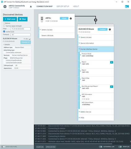

Central HIDS example can't connect with BLE HOGP mouse
Hi, I tested Central HIDS example in nRF Connect SDK 2.1.0 with NRF52840DK. The example works with my BLE keyboard, but does not work with my BLE mice. The followings are messages for the BLE mice. How can I modify the example to connect them? The first mouse can connect with nRF Connect for Desktop, and the other can't. I have attached the connection information.
# ELECOM M-BY10BR
Filters matched on UUID 0x1812.
Address: F1:C9:30:38:03:00 (random) connectable: yes
Connected: F1:C9:30:38:03:00 (random)
Security changed: F1:C9:30:38:03:00 (random) level 2
The discovery procedure failed with -3
Disconnected: F1:C9:30:38:03:00 (random) (reason 8)
# SANWA SUPPLY MA-BTBL155R
Address: CB:D4:5B:20:AA:57 (random) connectable: yes
Connected: CB:D4:5B:20:AA:57 (random)
Failed to set security: -12
The service could not be found during the discovery
Disconnected: CB:D4:5B:20:AA:57 (random) (reason 62)
    With the first mouse you get "The discovery procedure failed with -3". 3 is -ESRCH, and lookin gat the implementation of gatt_dm.c this is only used in one case:
    	cur_attr = attr_find_by_handle(dm, attr->handle);
    	if (!cur_attr) {
    		/* We should never be here is the server is working properly */
    		discovery_complete_error(dm, -ESRCH);
    		return BT_GATT_ITER_STOP;
    which is when the attribute handle is not found. I cannot see from the log which attribute this is though, but it would seem that the mouse GATT server does not have it.
    With the second mouse you get "Failed to set security: -12" (BT_HCI_ERR_CMD_DISALLOWED), which is the same as in this thread. We cannot say more about the cause from the error, so a sniffer trace would be the natural next step.

  • I found that the error comes from L417 "discovery_process_characteristic" in gatt_dm.c https://github.com/nrfconnect/sdk-nrf/blob/v2.1.0/subsys/bluetooth/gatt_dm.c#L417
    However, this is not the reason why the Central HIDS example does not work with ELECOM mouse. Below is a list of attributes stored during the connection. In Logitech, all handles are stored sequentially, while ELECOM lacks some handles. This is a variation of behavior among BLE peripherals.

    ### (parse_characteristic) handle: 0x0020, uuid: 2a4a, properties: 0x02
    ### (bt_gatt_dm_attr) look for an attr with handle: 0x0020
    ### return: 1, handle:0x0020
    ===> It find the DM ently
    ELECOM
    ### (bt_gatt_dm_attr) Attr store, pos: 0, handle: 0x0017, uuid: 0x2800, uuid_size: 4
    ### (bt_gatt_dm_attr) Attr store, pos: 1, handle: 0x0019, uuid: 0x2a4e, uuid_size: 4
    ### (bt_gatt_dm_attr) Attr store, pos: 2, handle: 0x001b, uuid: 0x2a4d, uuid_size: 4
    ### (bt_gatt_dm_attr) Attr store, pos: 3, handle: 0x001c, uuid: 0x2902, uuid_size: 4
    ### (bt_gatt_dm_attr) Attr store, pos: 4, handle: 0x001d, uuid: 0x2908, uuid_size: 4
    ### (bt_gatt_dm_attr) Attr store, pos: 5, handle: 0x001f, uuid: 0x2a4d, uuid_size: 4
    ### (bt_gatt_dm_attr) Attr store, pos: 6, handle: 0x0020, uuid: 0x2908, uuid_size: 4
    ### (bt_gatt_dm_attr) Attr store, pos: 7, handle: 0x0022, uuid: 0x2a4b, uuid_size: 4
    ### (bt_gatt_dm_attr) Attr store, pos: 8, handle: 0x0024, uuid: 0x2a33, uuid_size: 4
    ### (bt_gatt_dm_attr) Attr store, pos: 9, handle: 0x0025, uuid: 0x2902, uuid_size: 4
    ### (bt_gatt_dm_attr) Attr store, pos: 10, handle: 0x0027, uuid: 0x2a4a, uuid_size: 4
    ### (bt_gatt_dm_attr) Attr store, pos: 11, handle: 0x0029, uuid: 0x2a4c, uuid_size: 4
    ### (parse_characteristic) handle: 0x0018, uuid: 2a4e, properties: 0x06
    ### (bt_gatt_dm_attr) look for an attr with handle: 0x0018
    ===> It fails as handle 0x0018 does not exist.
    Why, this happens? I capture BLE packets (1) ELECOM + Central HIDS example (2) ELECOM + iPad. The example reads GATT database by "Find Information 0x04", while iPad does by "Read by Type 0x08". (See details in the attached files. You need filter ATT packets by "btatt".) I also found that Windows 10 also use "Read by Type". This causes the lack of information in the Central HIDS example.
    So, I wan to change the method to read GATT database by not "Find Information" but "Read by Type" like iPad does. How can I do this?
