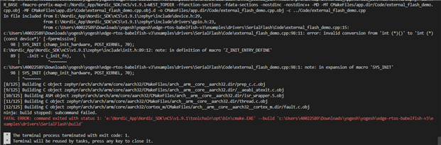

I'm running into quite a strange problem which is that when trying to use SYS_INIT function, getting an error: invalid conversion
from 'int (*)()' to 'int (*)(const device*).
ERROR message
I have seen all the related issues in the forum, But haven't come across any clear solution.
kindly suggest how to solve this issue.

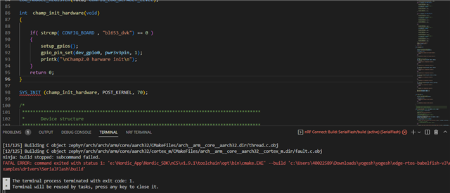

    The function pointer SYS_INIT takes in a parameter, which your function does not. The compiler then gives an error of conversion.
    Change your function to:
    And see if it works better now.
